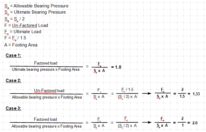

References to ASD design in the US, or others outside of Australia are only confusing the question. The OP states this is in reference to Australian Standards, where ASD has not been in codes for a long time. The Aus Standards do not give Allowable loadings for wind or seismic. They give Ultimate or Serviceability but not Allowable. Using background from other codes may have some basis for gravity loads, but without a proper comparison of the derivation of wind and seismics loadings in Australia these comparisons are guesses at best.
For the OP - you will need to go back to the geotech and get Ultimate and Serviceability parameters from your geotech. The publishing of Allowable values by goetech is unfortunately common place, and for gravity only cases can suffice, but they are not useful for lateral loads. Both the piling (AS2159) and retaining wall (AS4678) are written in limit states codes, so there is no excuse to not get them. The appendix J of AS4678 is a useful guide, however it is for Ultimate and Servicablility, not Allowable.
Below is a comparison of the three design cases. You be the judge on which one is preferred.
Thank you everyone.
Looks like the best way is to get the ultimate bearing pressure.
So, If ultimate bearing pressure is provided. For gravity can I simply compare the stress under 1.2G+1.5Q with ultimate bearing stress or do I still need to compare stress under G+Q with allowable bearing stress for the settlement issue that r13 mentioned?
Also, For lateral, if ultimate stress is used, do I still need to apply a FOS, which is about 2.0-3.0 for overturning? My view is no as FOS is more of a ASD way. For limited state we have destabiliting factor which is greater than 1 for working out the design overturning moment and stabiliting factor which is 0.9 for capacity, so as long as the capacity is greater than design overturning moment then it should be satisfied. Am I wrong?
IMHO, the answer to both of your latest questions is "no", unless instructed by your design code, or your geotechnical engineer, otherwise.
