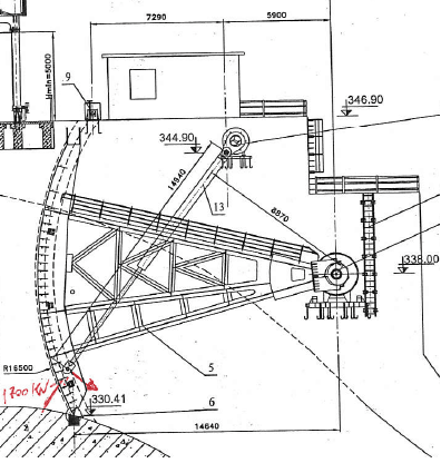

Hello, I'm struggling with a force problem.
I have a system where a mass P, connected to rod od variable length L. The mass is guided to move on the circumference 31500 mm.
To lift the mass I apply a force of 1700 KN on the same direction of the rod.
What I need to find is the force componet orthogonal to the rod (N), if there is.
Here the scheme:
Just for info this is a schematic rapresentation of a radial gate and I'm trying to find the bending stress on the rod, if there is any.

To be more clear this is my situation.
I need to know if there is bending moment on the rod of the hydraulic cylinder.
I don't know the load, only that I need 1700 KN to lift it.
It is not a school problem, it was my curiosity just to know if there is a bending moments but now I know I was looking at it the wrong way. The rod has only axial load because of the hinges.
I am quite rusted on these kind of thinks.
furthermore : an hydraulic jack, by definition, can't support a bending moment (really very rusted)

if the rod is pinned at both ends, and the pins are free to rotate (not seized) then the rod is a two force member, axially loaded.
if the rod ends are not free then there'll be some end moment.
but, in the real world, there's weight to consider and dynamics of the rod, so the rod probably isn't a true two force member, and there'd be bending due to transverse loads (and friction in the joints).
There is no bending moment but the rod can buckle, which can cause plenty of bending.

By the way the directions of the N and P are to what is shown on the first diagram if they represent the tangential and radial components of the 1700 KN value. I suspect that you got the 1700KN by either 1) figuring out this value using the moments about the pivot point of the gate frame when knowing the locations of center of gravity of the gate and of its frame that holds the gate in a circular motion and by figuring out the moment of the frictional resistances at the two pivot points shown in the first diagram or 2)by knowing the load required by the hydraulic piston to lift the gate and its frame clockwise.
To figure out the N and P values, do to SCALE a vector diagram whereby the 1700kn will be the resultant value of N and P.
Oops spoke a little too soon, the resultant value will be P whereas the 1700KN and the N are components when using the directions shown in your first diagram.
Oh boy!! rereading my first response, the first sentence should read be "the directions of the N and P vectors should be of the opposite directions of what is shown in the first diagram." My second response still stand as long as the directions of N and P are changed to the opposite direction.
