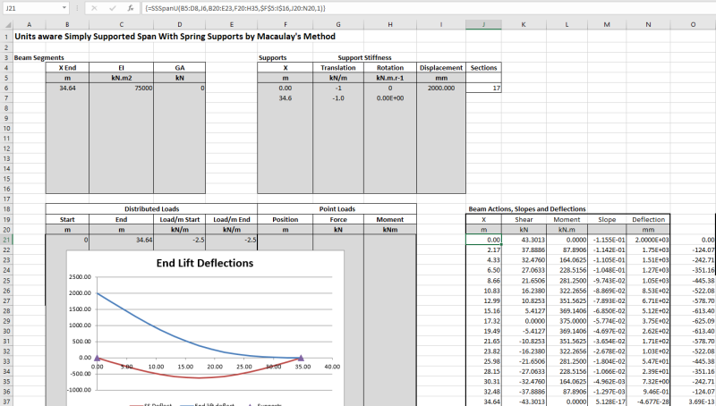

Here's the simply supported analysis, showing deflected shape for the horizontal pipe and pipe lifted by two metres, which rotates the right hand end to horizontal. I have also attached the spreadsheet.
Doug Jenkins
Interactive Design Services

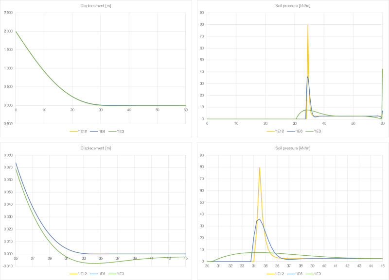

Regarding the force distribution at the contact with the ground, here are some additional results for the analysis cases I presented earlier:
is the force to lift fairly consistent ? From the graphs, I'd expect 1E12 and 1E6 to be very similar, and 1E3 to be a little lower (since slightly less pipe is being lifted).
what happens if you don't constrain the model at 60m ? (or if you did at 120m ?) If think the results show not much difference (since things look well behaved at 50m).
Is it interesting that peak soil pressure seems to happen at the same point, regardless of soil stiffness ? could this be an equivalent cantilever length ?
The force to lift is very consistent. I got 42.3 kN for all cases (as I think it should, since the portion of the pipe that is not in contact with the ground is a statically determinate system).
There are some variations in soil pressure along the entire length for 1E3, so a larger length could probably stabilize it a bit, but I don't think it would be too significant.
The resultants of the peak stresses at ground contact do seem to be located around the same point. I don't know about an equivalent cantilever, as there is only support on one side, but maybe we should think of an equivalent support length.
