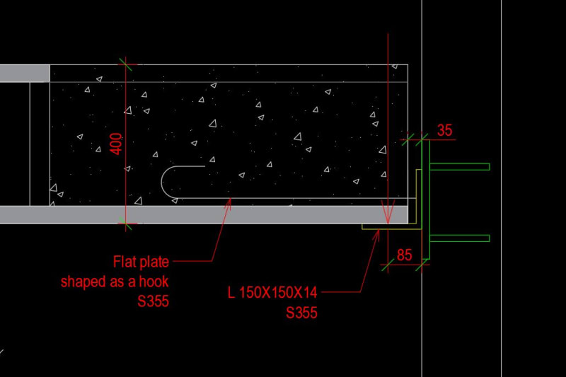

Hello All,
I have a situation where I need to use an angle beam to support hollow core slabs. The angle beam will be welded to fixing plates that will be pre installed in a cast-in- place concrete wall. Each fixing plates have 4 bolts providing anchoring to the wall.
For the design, I have been suggested to consider 2 design stages, before and after concreat topping reaches its design strenght. The loads and design actions to the fixing plates of each stage are as followed:
Stage 1- Before the concrete topping reaches its design strenght
Only hollowed-core slab weight + concrete topping are concerned.
The vertical load in this stage will create shear and moment to the bolts of fixing plates.
Stage 2- After the concrete topping reaches its design strenght
Hollow core slab weight + concrete topping + super-imposed dead load + super-imposed live load are concerned.
The vertical load in this stage will create only shear to the bolts of fixing plates. This is because once the concrete in the gap between the angle beam and the hollow core slab ends reaches its design strength, the angle beam will not be able to tilt forward. As a result, it will not introduce tension to the fixing plate bolts.

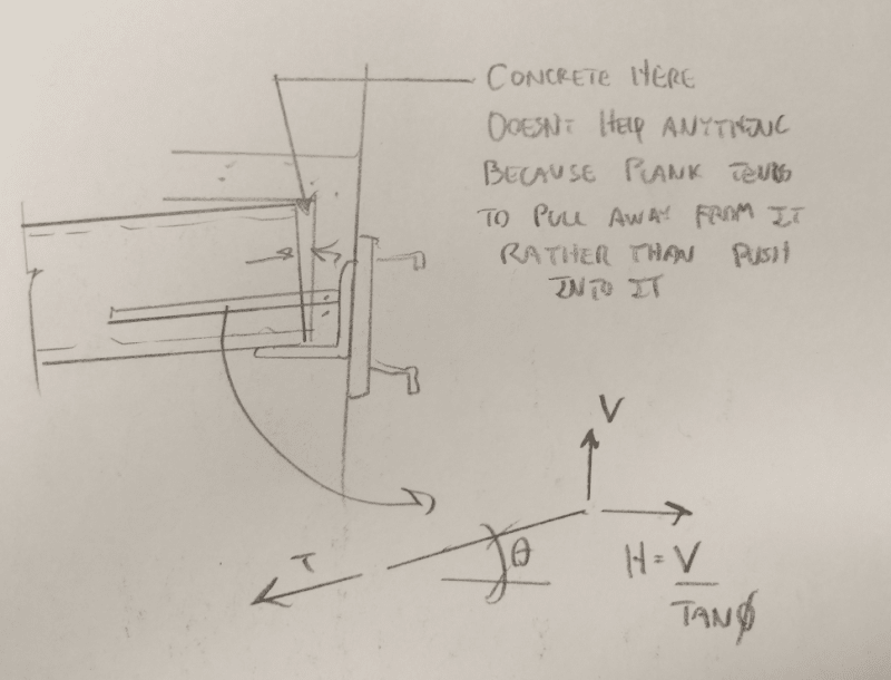

Let me preface by saying that at first glance, I would not trust the outstanding horizontal angle leg to support hollowcore planks of any appreciable length.
The angle leg bent about its weak axis will begin to rotate, resulting in less bearing area as it rotates and a P-delta effect will ensue.
But, to answer your questions, there will be shear on the bolts (I assume you mean studs)in both cases. The concrete in the gap will not eliminate the shear or moment.
The horizontal leg will rotate and as the hollowcore deflects, it will simply pull away from the concrete in the gap. The stages you describe above simply increase the load.
Increasing the load and filling the gap with concrete will not change the load path (unless something fails). Also, it does not appear possible to weld the hooked bar to the angle.

OP said:
1. Do you agree that there will be on shear applying the bolts in Stage 2 because the concrete in the gap will prevent the angle beam to tilt forward?
I do not agree for the same reason that MC gave. The plank end is rotating away from the infill concrete. As such, there's no way to mobilize the concrete in compression which is the only way one can really use concrete.

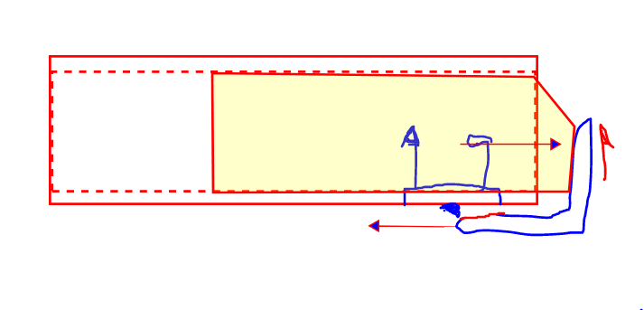

1) The bar is just a lateral tie between the plank and the wall. In this case the only load on the embedment is tension.
2) The bar is what we in North America would call integrity reinforcement. The idea is for the floor slab to retain vertical support in the event that the bearing angle is lost. In this case, per the sketch below, you would have both shear and a relatively monstrous amount of tension applied to the embed.
I see pretty much the reverse of that with respect to P-delta. I feel that the centroid of the plank reaction moves closer to the wall with increasing load. As such, the lever arm on the plank reaction decreases with respect to bending in the horizontal angle leg. In my mind this is the opposite of P-delta wherein displacements tend to amplify bending moments from those calculated on an undeformed structure.
Would you distrust beam seat connections? I think you can make this detail work fairly easily, as it is essentially an unstiffened beam seat with likely lower load as the angle covers the width of the panel. I don't like the hooked bolt because it could transfer moment, and with that small lever arm cause concrete to fracture somewhere.
...as it is essentially an unstiffened beam seat with likely lower load as the angle covers the width of the panel.
Comparing this detail to an all steel, beam seat detail, I would consider this to be much worse because:
1) Brittle, concrete anchorage is involved.
2) You have plank that wants to deliver a lineal load but a seat angle supported only intermittently by embeds.
3) To the extent that the angle between embeds picks up load, the angle experiences a bunch of icky torsion.
4) Relative to steel, the horizontal angle leg will be longer for precast, inducing more moment.
5) Depending on how the plank is loaded, you can pretty easily wind up with torsion on the embed plates.
6) Concrete has nowhere near the bearing strength of steel so you wind up with the center of the reaction closer to the tip of the angle load with concrete.
7) Your average plank is going to have more flex in it than your average steel beam which, again tends to push the load toward the tip of of the angle until it yields flexural and rotates to match.

First of all thank you for your answers.
@Motorcity,@Kooth,@canwesteng, I personally feel ok with the horizontal leg of the angle beam supporting hollow core slab. The deflection in ultimate limit state of the beam's leg is only 1.5 mm. But, the idea of considering only shear the fixing plates' studs made me feel uncomfortable.
@rowingengineer, the bolts I mentioned are the studs welded to the back on the fixing plate (A green piece on the sketch. Sorry for using the wrong word. The deflecion of the beam horiontal leg is 1.5 mm in ultimate limit state.
@wth, The deflecion of the beam horiontal leg is 1.5 mm in ultimate limit state. I don't know if this is considered low delection when the lenght of the beam leg is 150 mm. It is interesting to see that this "shear only" argument has been heard by someone. I just wish I could be more comfortable believe it.

rowingengineer said:
I think the same principles can be used in the design of the angle.the flange thickness used in the tests is similar to the angle. The question on the stud load will be found by the strut tie model.
I doth protest. The rather massive difference between an edge beam and a ledge angle is that;
1) The edge beam is free to twist over its entire span to match the end slope onf the plank (exceed it really) and;
2) The ledge angle will have rigid torsional restraint at close intervals such that it cannot match the end slope of the plank.
That difference changes the character of the problem significantly.
Is it? The hook and the concrete don't form a strut and tie to deliver the load to the radius of the angle?
1) The tie cannot form unless the strut also forms.
2) The strut cannot form unless the support angle is torsionally flexible enough that it rotates until it bumps into the plank/grout.
3) I submit that:
a) a typical, open cross section beam is torsinally flexible enough between it's vertical supports for this mechanism to form. Both the plank end and the supporting beam rotate and, crucially, the beam rotates faster such that it eventually bumps into the plank/grout.
b) an angle, rotationally restrained at the supporting wall at 2'oc - 4'oc is not torsionally flexible enough for this mechanism to form. Both the plank end and the supporting angle rotate but, crucially, the plank rotates faster such that the angle never bumps into it.
I agree, but in stage 2 it doesn't matter the concrete is doing the work once set, and yes in stage 1 the angle needs to be designed to take the load of the plank and topping slab or propping provide. But this isn't a hard calc and at 14mm thick flange should be ok.
This would seem to be where we disagree. I feel that, before the angle would rotate enough to bump into the plank end in stage two, these two, horrible, brittle outcomes would come to pass:
1) The welds connecting the angle to its embed supports would fail.
2) The the embed itself would fail under the imposed moment + shear.

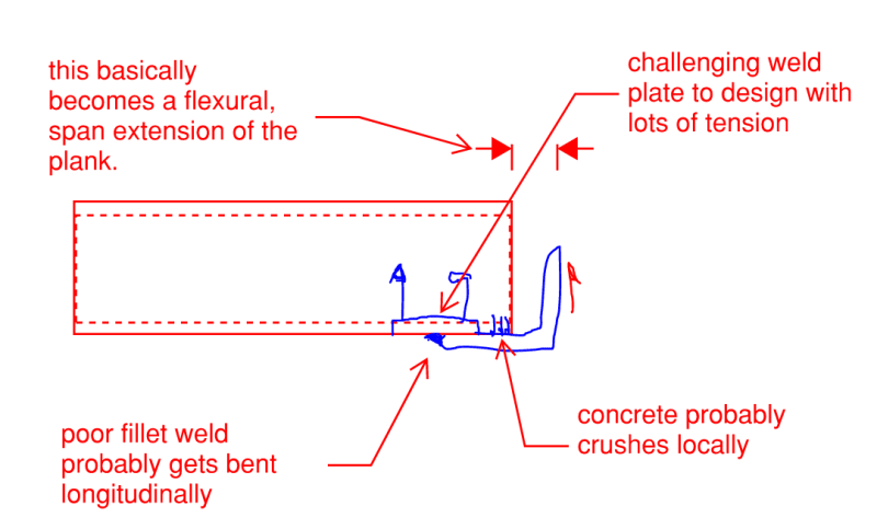

rowingengineer. said:
Some extra food for thought, What happens with the so called edge beam when it is loaded both sides and is no longer and edge beam but an internal beam with no torsion?
I agree completely with your concern. Moreover, most true edge beams will be endowed with a fair amount of torsional restraint at their ends. As such, I suspect that you have the nifty strut and tie mechanism in play in the middle of the beams but not near the ends.
I suppose that one could capacity design these brittle things for the plastic yield capacity of the horizontal angle leg. 1.25 Fy etc. I suspect that would lead to some substantial anchorage forces however.
Hi everyone,
Thank you for ffurther discussion. I talked to my senior who suggested me this shear only idea again and it turned out that I misunderstood him. In his opinion the loads applying to the slab after the topping concrete reaches it design strenght also introduce moment to fixing plate studs but with small amount. The eccentrictiy of such loads is equal to the thickness of the L beam. In my case it is 14 mm.
For the first stage the position of load resultant for hollow core slab+concrete topping is considered to be at 50 mm from the end of slab. The gap between the wall to the end of hollow core is 35 mm. As a result, the eccentricity of hollow core slab+concrete topping load is 85 mm. So the total moment applying to studs according to Eurocode load combination is as followed:
Total moment= 1.35*(Hollow core + Concrete topping)*0.085 m + (1.35*Super-imposed dead load + 1.05* Live load)*0.014 m
The hook presented previously turns out to be flat plates shaped as a hook to act as horizontal ties. I have to confess that I am still confused with this whole thing but my senior sounds pretty firm with his suggestion. So, I will just go with that. Justification about eccentricity of the loads after casting concrete topping makes me feel more comfortable with this design.
