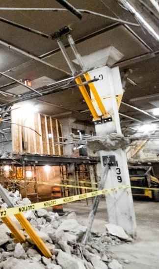

Definitely don't have to be. But as a contractor I've found the angled props easier most of the time. If I go vertical I need more robust scaffolding to get to the underside of the stairs to put solid blocking / angle (non-swivel head props have 6" head or so which needs to be blocked to get sufficient bearing). Safer / easier to put a 2x cleat off a ladder, clean the rubble, then come and place falsework which now doubles as my walking surface); scaffolding twice (once for install of blocking at prop head and then again for forming) is expensive so I like to avoid it. The props also need to be much longer because they no longer go from flight to landing (vertical props are flight to flight and at the top they can be very large - might be hard sometimes to negotiate those into the stairwell). Angles and blocking at base take no time at all since we use those in large quantities for lateral shoring against foundation walls / columns. Just a quick screw anchor or two and you're done.
Shoring is mostly about using what you have and since I have these items I tend to use them. This particular job (in drawing above) I had an issue that I couldn't obtain any more peri props since the rental company was out. So I could only shore with what I had, which was mostly No.2 post shores. Hence why some things look really funny (it was to make the distance short enough so the No2s would work lol).
Below is example of angle/blocking configuration. Have 100s of these guys just sitting around so easy to pick-up for misc stuff.

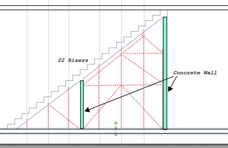

That is a long stair. Maximum height about 14'-0". Supports shown in dashed red lines would likely be wood posts, braced to prevent buckling. Verticals would have to be recessed into the underside of stair slab to achieve satisfactory bearing. Alternatively, steel bearing plates could be attached to the soffit using suitable anchors.

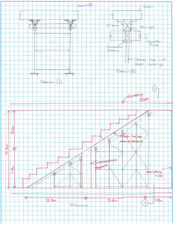

@BAretired Please forgive for the misinformation in my thread. The stair does not span till the wall, it stops at the slab. I have attached what i understood and is proposing for any corrections to be made and all guidance.

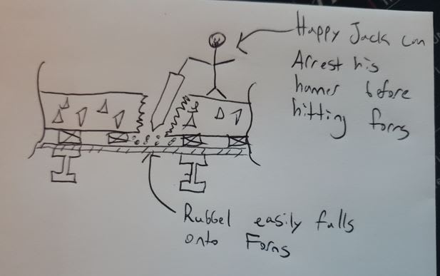

If you can let the concrete fall that is always preferable since it is much faster. Demo is quick and cleanup is similarly so. Chipping onto forms is a massive pain since the debris has to be entirely manhandled, and the concrete doesn't break nearly as easy since it has continuous support. Naturally then if I can at all help it I always chip and let the debris fall. If there is mechanical I protect it (plywood box of some sort), and if the slab below is suspended I shore it for the impact loads. Much cheaper than chipping onto forms.
However, sometimes you are restricted such as when you are chipping overtop a mechanical room or hydro vault. Perhaps you are restricted in your case because you can't shore the slab below or whatever. In these cases, we do chip on to forms as much as I hate doing so (because well we have to). But we lower the forms with a sleeper of sorts (usually 2x4). This does two things:
1 - It protects the form surface from hammer strikes
2 - It allows the concrete to break away more readily since it has somewhere to fall. Concrete in continuous contact with a surface is very difficult to chip with hand tools
Pardon the crude sketches. I'm on the way to the airport and I am poor illustrator at the best of times.
You can see the big guys chizzle is just ripe to go through the form surface. That's bad because you have to either replace the surface after demo (formply is expensive...) or else skin it before chipping (with something less expensive than formply). The skinning practice is cheaper but still leaves the issue that the concrete won't break easy.
Sleepers help with that
If the soffit of the stair is resting on steel angles at an angle of 40.7 degrees, the coefficient of friction between steel and concrete is not sufficient to resist the friction, so the vertical weight of the concrete will add to the lateral force on the false work, particularly with vibration from the jackhammers.

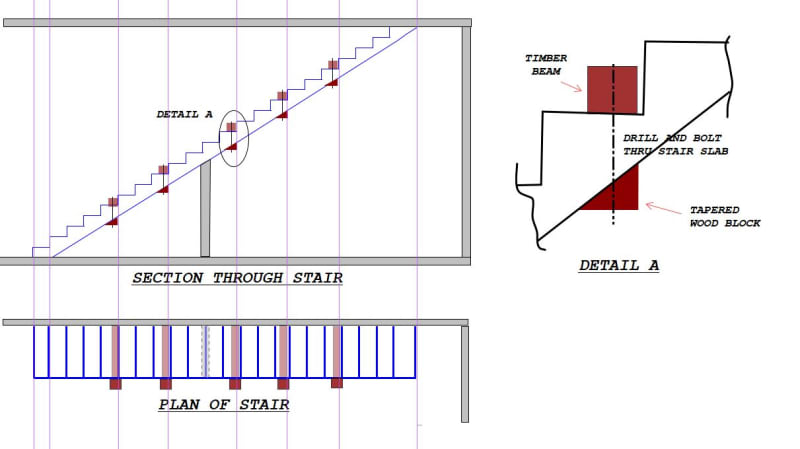

As mentioned by Enable, why not omit the deck under the stair and let the rubble fall directly into bins on the ground? The existing stair slab could be carried by short wood beams supported by wall on one side and posts on the other, drilling through the stair slab and providing two bolts for each short beam.
I like Enable's idea because it can protect that piece of mechanical equipment in the corner. The other areas are okay to demolish and let the rubble fall into bins.
I think we can eliminate all the lateral bracing entirely. If you use telescopic support braces (lally columns/screw jacks) that can extend to the correct height, we don't have to worry about Euler buckling. It also means you don't have to field cut wood, and the jacks are reusable. We don't need lateral bracing for movement/vibrations perpendicular to the stairs because we have a solid support at about midspan.
Yeah milkshakelake, getting rid of all that framing seems like a winner to me.

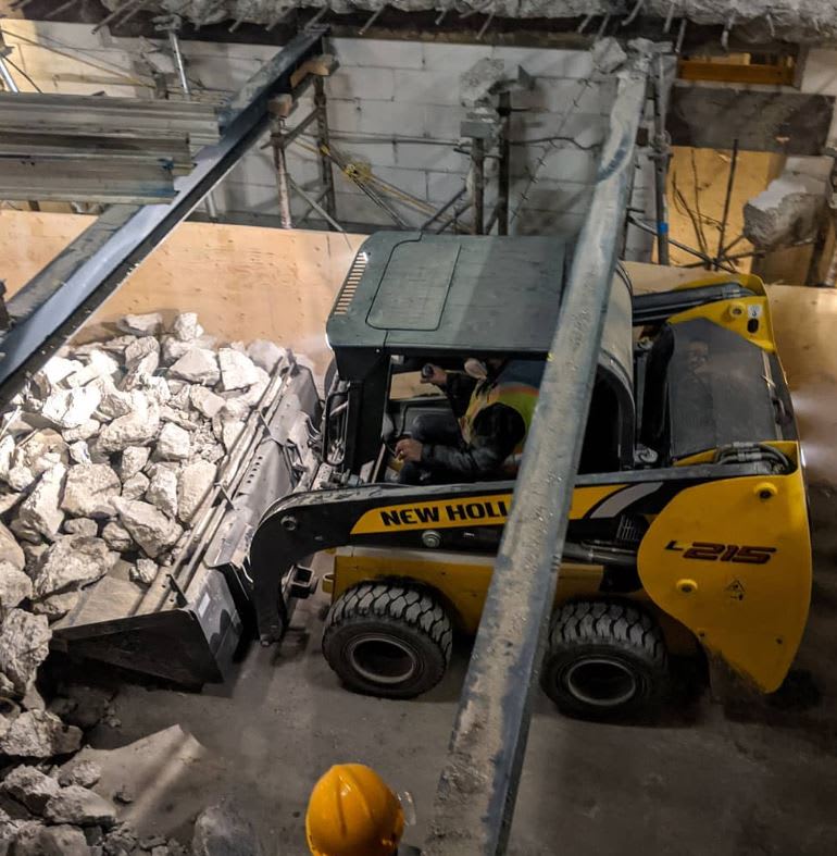

The contractor has informed that they will be taking out the equipment below stair and can allow for free fall on to bins or form boards.

@BEretired the adjacent wall is too old and cannot be used to support the short beams. Could you please elaborate the methodology on providing short beams drilled to the other side of stair and supporting them using props on either side.

Sounds like baloney to me! Use beam hangers bolted into or through the wall. If the wall is that bad, it should be removed along with the stair.
But it looks fine in the photo.
@BAretired was instructed by client like that, will have a word with them.
Could you please explain the methodology for the short beam method?
