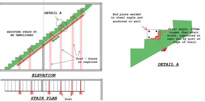

You are welcome ikka, but I am not happy with the detail through the stair slab. The problem is that the coefficient of static friction between wood and concrete is too low, which means that the tapered block will slide up the slope. I will send a revised detail ASAP.
@ikka,
Further to my last post, I recommend a change in Detail A to prevent slippage of the tapered wood block on the underside of stair when the jackhammers get close to each of the support beams. It is better to drill perpendicular to the stair rather than vertical, allowing a plate and nut parallel to the stair soffit which won't slip. The short beam on top could be timber, but I thought that an angle would be easier to anchor to the wall. It also provides more room for drilling.
If the stair was adequately doweled into the wall, we may not need vertical support on that side, but we don't know that and the possibility of sudden failure is not a risk worth taking.
It appears to be a very narrow stair; I'm guessing less than one metre in width. It is also very steep. It is possible that the original designer intended the width of stair to simply cantilever out from the wall. Again, we don't know that and we cannot reasonably assume that to be true.
Please let me know if you have any comments or concerns about the sketch below.
ikka said:
@BAretired Thank you for your time and effort, will change design accordingly.
Don't change the design unless you agree with it. Discuss it with senior members of your firm before finalizing the design. Remember, you are the EOR, not me. This is an unusual engineering assignment and deserves careful consideration.
I encourage you to review the statics, particularly during jackhammer operations.

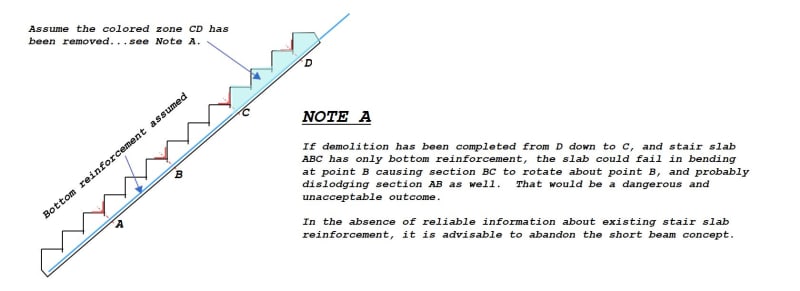

@ikka,
I have a new concern today which had not occurred to me earlier. See the sketch and note below. You may have to choose a more conventional method of shoring.
