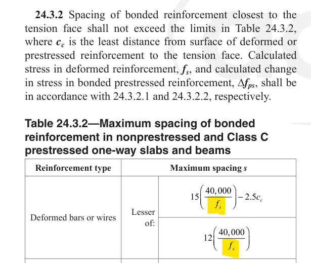

For strip foundations, one-way slabs, retaining walls, etc. working stress analysis is useful to determine the stress in the reinforcement at service level to increase the permissible maximum bar spacing per ACI 318-19 24.3.2:
