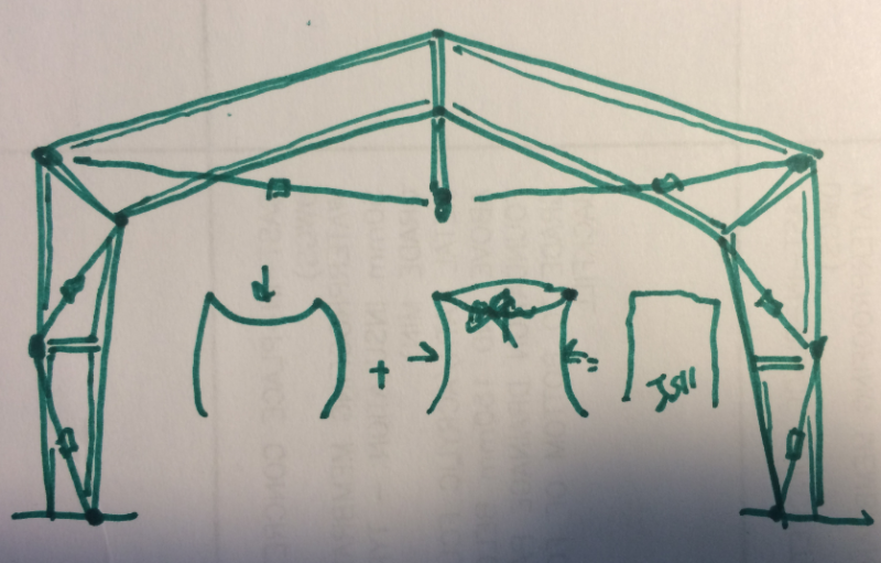

This will be a little off topic but what the hey. When I look at your frame geometry and the supplied reactions, a couple of things jump out at me:
1) Gravity loads contribute a good deal to the reactions and;
2) I suspect that the reason for pursuing base fixity was to limit a) midspan roof deflection and b) lateral wind drift.
If you could talk your PEMB supplier into a little adventure, I wonder if post-tensioning the frame might be an elegant improvement here. While exotic looking, in this instance, post-tensioning would simply involve some extra, routine hardware and a couple of extra installation steps. There would be cost involved but, perhaps, less cost than some of the rather extreme foundation solutions that we've been contemplating.
As I see it, post-tensioning would have the following advantages:
1) You could essentially undo much of the gravity load deformations. This would be similar to load balancing in PT concrete.
2) You could stiffen the frame against lateral drift by making the rafter assembly stiffer. It would be closer to the stiffness that one would expect with a center line of columns.
Just realized that I've got my PT rods in backwards in the columns. Please think of them mirrored about a vertical axis.
More gooder.
