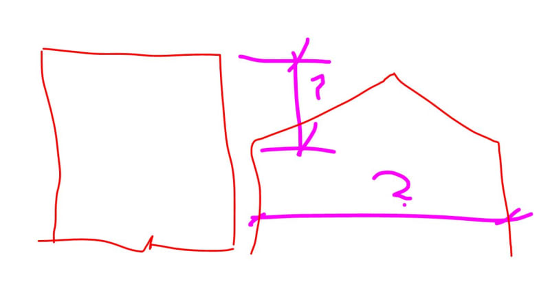

Would anyone ever consider framing a new roof on top of an existing PEMB? I have someone who has adjacent pre-engineered metal buildings and wants to frame a new roof between them to get rid of the valley. Reasons to not do it:

How wide is the PEMB and how tall is the step between buildings?
Also, what is the reason to do this? What is the client trying to achieve? Better drainage? Less snow buildup?

Wait, is this two existing buildings, or is this one existing building that a new one is getting installed directly beside?
How close are they?
