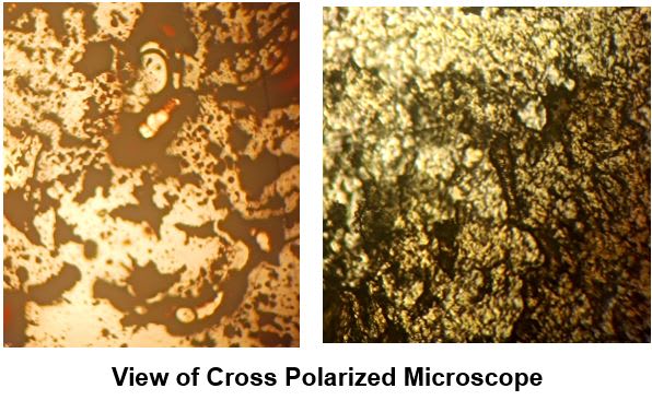

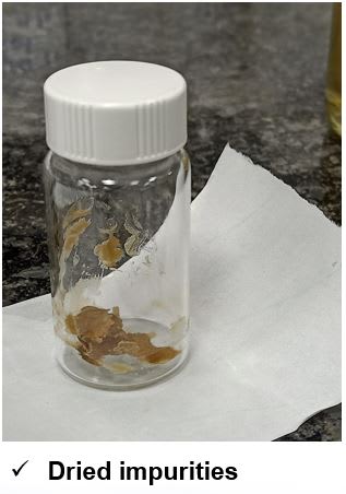

We are not finding filters choked physically, our R&D team did the tests by dissolving the paper filters in Toluene. First time they did find rust particles. Source of which is most probably the coolers. But, second time, they did not find any particles which can choke filters.
@ georgeverghese: yes these machines are in gas cracker plant. But, installed with DGS, with nitrogen as secondary seal gas and separation gas.
Below are images of impurities after toluene wash of filter element. Our R&D team says it is Wax.
Does sound like raw cracked gas is finding its way into lube oil somehow. Source of contamination can only be through DGS or from the lube oil cooler.
Same phenomenon is happening in crack gas compressor, ethylene refrigeration compressor, propylene refrigeration compressor, and other three compressors which handles hydrogen and mixtures of hydrocarbons.
