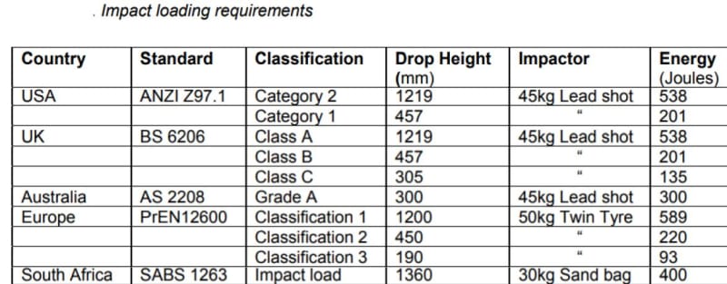

Most design codes ( if not all) require impact load assessment ( see attached table). The static load requirement should also be appropriate to the type of occupancy, the loading requirement for public areas is very high as compared to residential applications.
