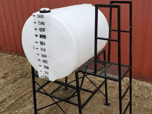

You can use flange plates if you are going to the column web, check the AISC design examples I believe there is one. However if you are doing a tank support you might consider HSS and bracing like so.
Dik yes!! I going to use very small W members. I think it's also acceptable.
As for HOPI message, it's i dont have any documentation to design tube conections but documentation to design w members conection, i do!! If you have docuemntation to design HSS conections, i would apprecciate it.
I have made a progress in my structure. I decided make it using rectangular tubes. I studied AISC Specification Chapter K: rectangular tubes conections. I would want to show you my calculus but i would like do it in a private way. I can't wait your comments.
I have another question: How are the braces conected to the tubes? bolted? Welded? Using plates?
Since you are using tubes for the 'frame', I would weld round BAR stock for the braces... depending on the loads, they could be 1/4" or larger. Because the loads are small, it's easy to develop enough weld to resist the forces, also welding of the face of the tube is not likely critical. Be careful of interference where the X-bracing crosses the opposite bracing.
