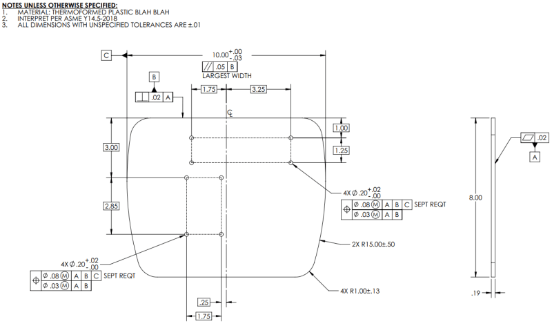

Hello,
I currently work for a small company, and it has no acknowledgement of GD&T. I recently took an online course for GD&T, and I think it can help a lot in production because supervisors constantly get inspected parts that don't fit even though drawings meet specifications. I believe its the issue with plus and minus tolerancing without any bonus tolerances. So I want to solve the problem by including some GD&T for the company. Keep in mind I am still learning--in no way have I perfected GD&T.
All images are mockups of parts--not exactly the parts due to proprietary reasons (obviously).
I have a rear cover/plate that is used to mount various subassemblies. The subassemblies are mounted by four holes in a rectangular pattern. I want to control the hole locations relative to each other, but I don't care too much about the overall placement of the hole pattern, so what I used was a composite position tolerance. Here is an image of the drawing.
Does this appear to be correct on what I am trying to do? Is there any issue with Datum Feature C? Would it be difficult to determine the center of the part due to the curve sides? I also read somewhere that if feature control frames have the same datum features, then the tolerancing is required simultaneously. Does that work in the drawing for both patterns? I don't want to have both patterns toleranced simultaneously; I want the two hole patterns to be independent from one another.
Since there is a mating issue. I also redid the mating assembly part. I just made sure the virtual condition equaled the hole pattern's virtual condition. Essentially, its the same tolerance as the cover.
This should ensure 100% fitment, right?
Thank you for anyone helping me out. I really do appreciate it!

Just few things here:
- missing Ø symbol in the feature control frames (composite)
- datum feature C symbol is incorrectly placed in the second/lower figure. That is datum feature C? The pattern of the 4 holes?
- what is the size of datum feature C in the upper figure ? 10.00 "largest width" is not completely defined in my opinion.
- GD&T purist will claim that datum feature B and C are missing perpendicularity controls to the higher order precedence A and A|B| respectivelly. So, here is that.
Add SEP REQT near the upper segment of the composite (separate requirements is already default for the lower segment anyway)
Thanks greenimi for your input.
- I can't believe I missed the Ø symbol; thanks for catching that.
- Ah, yes! I realize that the axes of holes are not considered a feature of size. I was tying to establish a center plane datum feature relative to the size of the part. I shall move datum feature C to the dimension 4.00.
- I can see how it's not fully defined? I think what you're trying to get at is that the largest width can be a diagonal across the cover while satisfying datum features A & B. What I intended is the largest width dimension parallel to datum feature B. Is there a way to say that in GD&T? Would it be just a parallel callout underneath the 10.00 dimension with "largest width"? I think "largest width" is needed because I don't want to confuse the width dimension between largest width and largest width colinear to radius centers (if that makes sense).
- Actually, good point. Completely forgot about form control.
- Okay, so there is note that says that. I'll add it.
I uploaded revised images regarding what you said (above). I really do appreciate you helping me. I learned like 5 new things! If you can, then let me know if there are still issues.

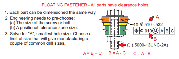

There is a little detail forgotten on the way to 100% fit.
Exactly what fastener are you trying to "fit" thru the holes.
Use this little formula and the Force will be with you:
amanz,
You have placed [±][ ]tolerances on your outline radii. This is practically uninspectable. I strongly recommend profile tolerances for the outlines, especially if they are anything other than straight, orthogonal geometry.
I try very hard to avoid using features of size (FOS) as datums, unless they are accurate. Your outline datum[ ]C is not. If this were my part, I would use one of the hole patterns as the secondary datum, and I would apply a profile tolerance all around the outline.
