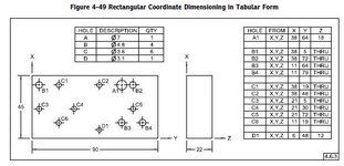

I have a plate which has some 500 hole of different sizes. Our usual practice is to provide a hole table with X and Y coordinates and a plus minus tolerance on the values. Is it possible to provide a positional call out to all 500holes and refer to the hole table as basic dimension. Thanks in advance.

Thanks for the brevity. My concern is, I have not seen this particular problem in any of standards.
And, usually we give the coordinates wrt to a coordinate system, but if I provide a positional call out I have to provide datums. Can I tell that datum A is XY Plane for the coordinate system, similarly for other datums.
As an example, this is a figure from Y14.5-2018. The related para. 4.6.3 says this:
"4.6.3 Tabular Dimensioning
Tabular dimensioning is a type of rectangular coordinate dimensioning in which dimensions from mutually perpendicular planes are listed in a table on the drawing rather than on the pictorial delineation. See Figure 4-49. Tables may be prepared in any suitable manner that adequately locates the features."

Thanks a lot for your replay, I was looking at ISO. So now on this drawing I can just provide a position call out right?
Right.
ISO also has some "similar" example figures in their ISO 129-1 standard. The ones below come from the 2018 version.

Thanks a lot, I will combine hole table and add a position callout to the holes. However iso1101 does not mention about hole table.
I wouldn't be worried about that too much as 1101 isn't strictly about indication of dimensions and tolerance. Besides, 129 is listed in the Bibliography at the end of 1101.
