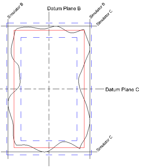

So hoping some experts can help me put a question to bed. I work in the electronics industry, so really don't need to use GD&T at all. However, our data sheet drawing has this call out, and it's been the source of much debate with some customers. I've attached a picture of how I understand it, but some customers are taking it to mean that the 0.1 profile zone encompasses the B & C edges of the part. But those are datums, so shouldn't be included, right? In general, I think it's just a poorly done, but that's another issue.

Okay, you got me on this one. You're absolutely right, I hadn't thought of irregular features of size at all. Basic widths and profile are used with those, the examples clearly show it. I'm not a big fan of the irregular features of size section - I don't think the definitions are very clear. Perhaps this is why I didn't think of it - it never entered my mind to apply the "irregular" concept to a feature that has "regular" geometry (two opposed parallel planes). This does not seem very intuitive to me at all, and must be very confusing to those who don't obsess over the Y14.5 standard like we do.
But I would disagree with the interpretation of the zone availability. If B and C are treated as features of size with centerplane datums, then I would say that the entire zone thickness is available for the B and C surfaces. Like this:
So the form of the B and C surfaces, and maximum angular error between them, is the same as it would be if only A was referenced (or no datum features).
I would agree that specifying the B and C datum features does make a difference. Aligning the profile zone to the two B surfaces will be different than best-fitting it to the four surfaces together. This will need a different figure though.

I read pmarc's reply but since Dave asked for an explanation I was kind of waiting on that. That being said, I do see what pmarc is saying. Since the profile tolerance specifically calls for a tolerance zone equally disposed about the datum plane, only half (to the inside) would be available since the datum simulator would take up the other half. This means that I agree with pmarc and rescind my previous comment on the drawing.

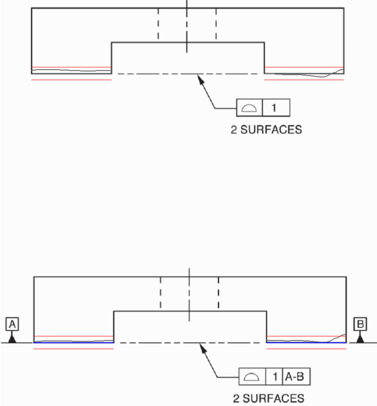

Here is how I would envision the situation for the coplanar surfaces:
I've shown the same as-produced surface geometry for both cases. When no datum feature is referenced, the surfaces can occupy any part of the zones and the control is equivalent to coplanarity. When the A-B datum feature is referenced, the surfaces must have high-point contact on simulators located at the basic surfaces.
I believe that this is fully consistent with pmarc's description.

Thanks -- that's how I envision it too. The situation I'm dealing with had the typical A, B, C, edge datums (with no GD&T relating those features to each other), and then a general note imposing profile of a surface 3 mm everywhere unless otherwise specified. Thus you all can see the problem; half of that profile tolerance is lost on the surfaces creating the datums.
I keep telling them about it, and suggesting that they "qualify" A, B, and C (flatness on A, perp on B, etc.) so that those surfaces are exempted from the general profile note. We'll see if it goes anywhere.

Evan, I don't think there's a real difference between our points of view regarding JPs first drawing. The zone still extends from the high points inwards with a coplanar type callout. It would be the same if the coplanar features were then referenced as datum features. I think the only way a tolerance zone is actually centered about a true profile is when the scenario is as JPs second drawing--although only half the zone is available, and when the features are actually toleranced from a datum reference frame and not used as datum features at all.

Evan, if you made the profile unequal you could have anywhere from no tolerance to all the designated tolerance.
It's actually even more interesting, because it depends on the process you use to establish the datum.
If you use hard gage to establish "highest points" datum, then only half of the tolerance is usable on the datum features.
If you "average" your CMM measurements, the entire tolerance is available.

If the datum feature is the center plane (B and C) of the part then the full profile tolerance is available.
If the datum feature is the surface (right vertical surface OR left vertical surface for datum feature B; top horizontal surface OR bottom horizontal surface for datum feature C) then only half tolerance is available.

It sounds like there is still a difference in our points of view. I'm saying that the tolerance zone is centered about the true profile in both cases. I don't see the zone extending from the high points inwards in either case. Please see the additional example below. Here is the logic:
1. The tolerance zones have basic location (centered about the true profile).
2a. If no datum feature is referenced, the toleranced features can be simultaneously fitted (rotated and translated) relative to the zones to get the best result.
2b. If datum features are referenced, the datum feature surfaces must contact the datum feature simulators at their high points. The datum feature simulators are coincident with the true profile.

I believe that you're correct. If the B and C datum features are width features with centerplane datums, then the entire profile tolerance is available for the B and C surfaces. If the B and C datum features are each single planar surfaces, then only half the profile tolerance is available for the B and C surfaces. Strange, isn't it?
