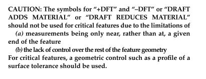

Kedu,
I am not very familiar with Y14.8 and its methods, however I will take a stab at answering your questions after reviewing the applicable sections.
1) Just to get it out of the way, I can see some of the advantages of specifying a part using the methods shown in Y14.8, mainly to provide flexibility to the tooling designer and casting/molding/forging supplier, especially during the initial development/prototyping phase. That being said, utilizing these methods just adds additional ambiguity to your product definition (as you have already seen - it is not nearly as thorough and vetted as Y14.5, and even that is open to interpretation in certain sections) and I would highly recommend that a 3D model and associated drawing be developed ASAP at some point prior to production with the EXACT geometry of the product per Y14.5, and ditch most of the conventions suggested by Y14.8 (at lest those with little to no support in Y14.5 such as +/-DFT) otherwise you are leaving yourself open to a myriad of issues down the line, especially if disputes arise over issues with the product at your assembly plant or in the field resulting from geometrical variation/print specifications.
2) Your +DFT/-DFT looks to be some sort of pseudo profile tolerance, and I do not think it should be combined with a traditional profile callout. In the section you mentioned 3.6.1c and 3.6.1d they both include the verbiage "in addition to the increase allowed by any applicable tolerance applied to the considered feature" and reference the figures 3-6/3-7 both of which ONLY consider directly +/- toleranced features. I would not combine this with basic dimensions.
3) Located on several of the figures and at the end of section 3.6 is the below cautionary statement. This leads me to believe that +/-DFT and traditional profile tolerance are mutually exclusive and cannot or should not be combined as I read this statement to mean "use profile instead of +/-DFT for critical features" not to combine them. That being said, after doing some searching I've seen the two combined as you described and interpreted several different ways. Since this is not supported by Y14.5 and even in Y14.8 is not clearly defined, you will never get a clear answer on this and everyone will have their own interpretations. Feel free to develop your own internal standard to define this for your use if you really feel you need it but I would personally avoid this at all costs.
