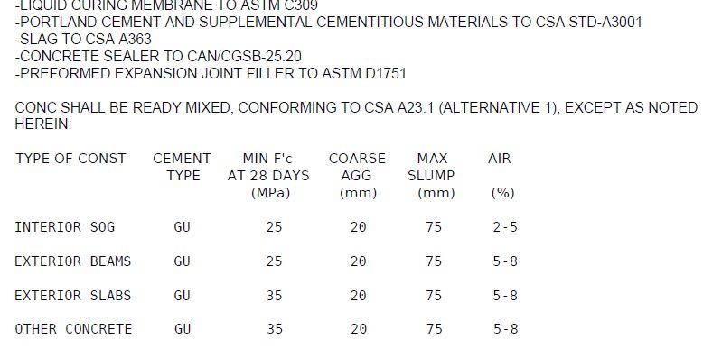

I just use LibreOffice and if I need tables, I can use them. Alternately, I set the text up and use 'DejavuSanMono' for the font instead of Arial... This gives columns like:
Dejavu... is about as close to Arial as you get. This is from an actual drawing... it goes into drawing notes as Arial with the Dejavu edited to suit.

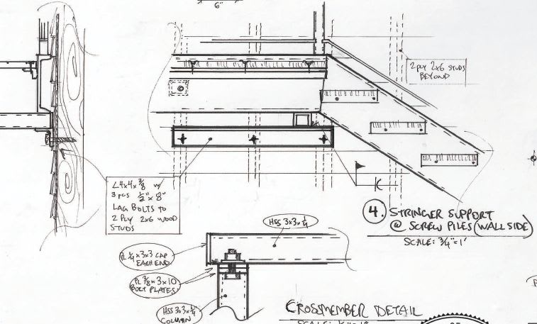

Part of my work is reviewing and sealing shop drawings. One customer still does manual drafting... I'll check and see if I can find a sample of his work; it almost brings tears to your eyes. It's so good.
Oh you young people. I have seen stone tablet drawings from sesoM drafting. Beautiful chiseling.
Somewhere in my negative collection, I have photos of the original St.Boniface Basilica drawings that burned in Winnipeg in the late 60s (?). The metal trusses supporting the dome had filligree web members and these were all drawn by hand. The original drawings were on linen with ink.
Others, more recent...
