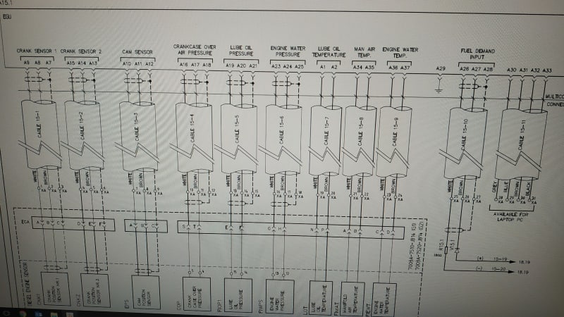

Hi everyone.. Please assist on my brainstorm...
DieselGenset 11kV 50Hz 3.3MVA
It was fully commissioned in 2011 and used for emergency cases and plant Turnaround activities. Working Load was about 1.1-1.2MW (40-45%).. Last year we got some new facilities, and load increased. So we noticed, that on 1.3-1.4MW frequency start jumping from 52 to 47 Hz.. If we add some more load - it trips by underfrequency. Fuel filters are clean, injectors replaced, valves clearness calibrated, electronic governor have no alarms.. on 1.1-1.2Mw frequency stable. It looks like "memory effect"... Any ideas? Please ask if any additional info required..

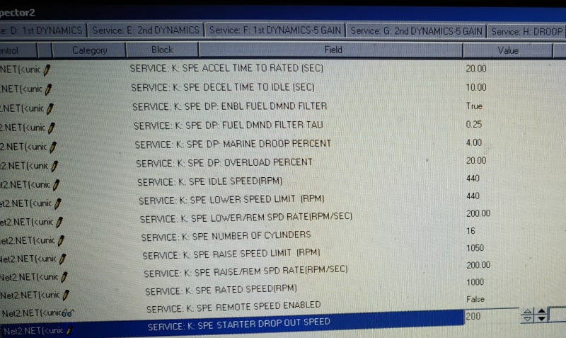

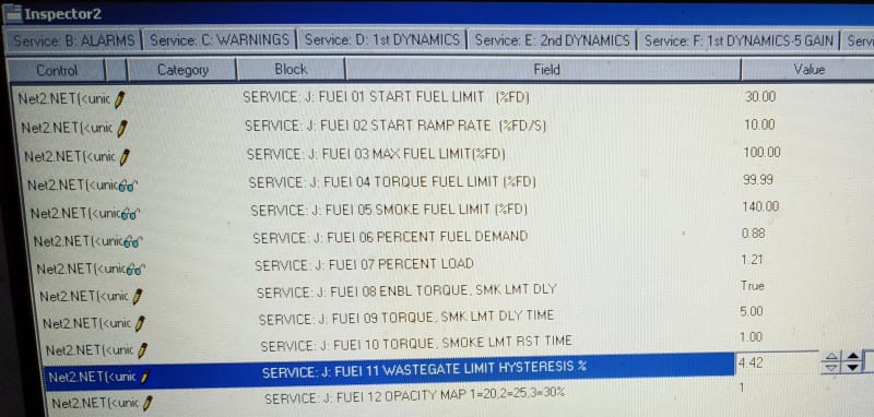

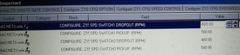

Well I tried Window Watch software, please see this parameters in photos attached.. Any comments? I confuse about FUEL SMOKE LIMIT - why it is 140% ? In manual nothing explained about it parameter..
Viktor
Electrical Technician II
I could not find any logic strings in software.. Ladder or block diagrams.. Nothing. Only parameters and settings.. How to check Woodward logic? Any experiences?

So from your pictures, it appears something is driving speed reference up to 1039 RPM, so it is either getting a signal from a DSLC or from a device wired into one of the signal inputs.
Fuel Smoke Limit, is used if a manifold pressure sensor (typical) is installed and is used to limit fuel delivery until the turbo spools up, mainly used on propulsion units, setting at 140% usually means its just set out of the way to prevent it limiting fuel signal output.
Your settings show a droop bias, usually droop is controlled by a digital input (most standard 723's input A, if you have a custom configured unit could be different), a lot of single unit gensets either have Droop set to 0 in the configuration or have a jumper from B+ to input A to always keep it in ISOCH mode.
If this commissioned fine and has operated successfully for a period of time it is likely not a settings issue, these units just don't change their parameters, they pretty much work or fail, and I have found them to be very robust in a number of applications. Most failures I have seen have been due to power supply issues.
There is no user access to internal logic, on custom units there is a customer version of a programming tool, but it is expensive and used to require a training class to use, limited mostly to OEM's. It is possible you have some custom parameters since instead of driving a fuel actuator this is sending a signal to the injection control module. But without a part number hard to tell.

1039 - its preset of 1000 plus 39 of droop bias.

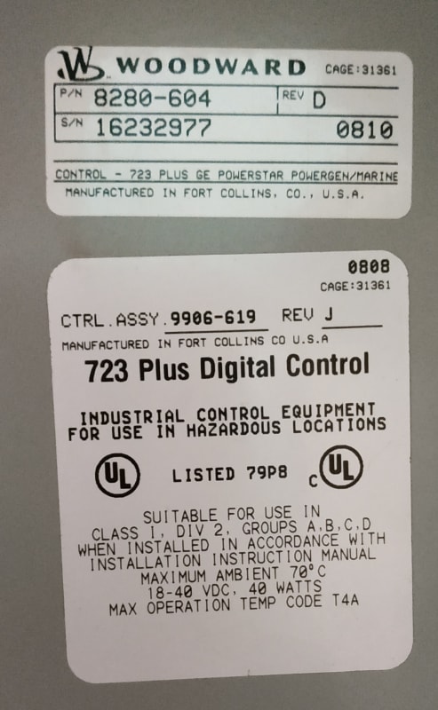

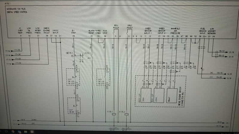

So your Woodward governor looks to be part of the GE PowerStar control system, I'd assume its mounted in an enclosure with 2 or 3 digital input and output modules and a controller identified as the ECU. By part number it is a standard control cage with a custom program developed for GE Transportation for their PowerStar controls. Most of these that I'm aware of had a common schematic with features added per job spec. Only schematic I can find is from a job for Marinsa in Panama in 2009, should be similar to yours but likely not exact. GE was pretty good about sending a documentation package with these units, do you have it?
Most of the GE PowerStar controls used analog output 4 for the "Fuel Demand" reference to the ECU, so if you measure that signal it can give you an idea of what the 723 is telling the injection control it wants for fuel, then you can see if the fuel demand signal is driving the instability or following it. Also check to see if your remote speed setting input is changing, not sure on your unit what drives it, but had a loose connection on one a few years ago that only seemed to be a problem at higher loads.

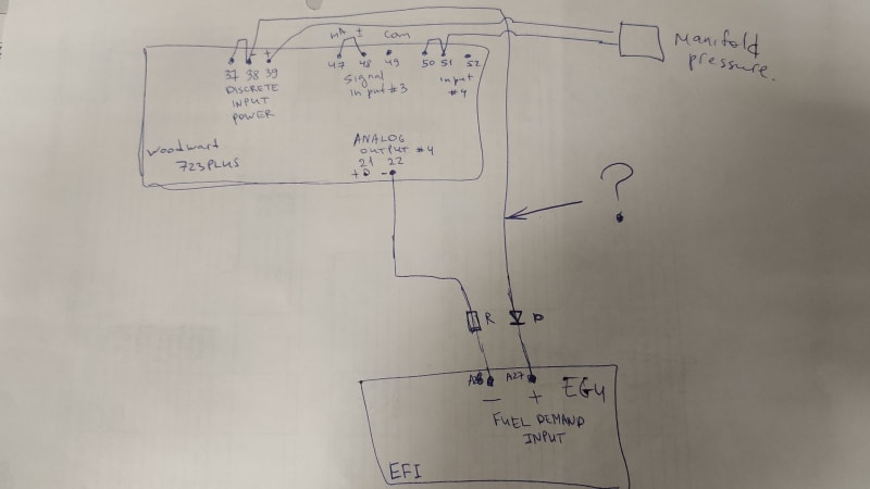

Hi everyone. Long time pass, and I still did not get problem solved. Our engineers looking forward to purchase load banks, but it is also long time issue will be.
catserveng, I have checked the signals for Fuel Demands and its changing while starting, then drop to minimum on idle. I still did not get chance to monitor it during load condition. But I notice, that connections of fuel demand signals and manifold air pressure are quite strange. Please see photos attached. Why not Fuel Demand connected just direct to Output +- on 723plus? And manifold pressure also not connected to input +-... Why it using Discrete Input power? So many whys, and nobody on my site can answer. Any experience on that, guys?
