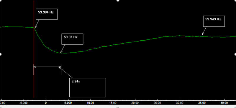

Frequency events are MUCH slower than voltage changes. For example, the image below shows large frequency excursion on Feb 17th. Note that the time scale is in seconds, with a time to reach the minimum frequency of about 6 seconds. The faults that typically initiate events like this usually take less than 0.06 seconds (~4 cycles). The average rate of frequency change for this event was about 0.03 percent per second.
