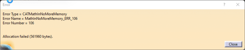

Hello,
I bought a new pc with a graphic card RTX 3050 (gaming card). Now I'm trying to open a project that I did on previous computer (also gaming graphic card, but doesn't know the model), and I'm unable to open it! The display is gray, and when tried to rotate or move the view, crashes. It looks that graphic card is given me an hard time. Can it be for be such an old version of CATIA and it doesn't run on newer graphic card! Any configuration that could help?

I've been diggin this,
Today it devolved me this message:
Any clue?

Try CATDUAV5 to fix any potential errors on the file;
With the file open:
File >> Desk >> Right Click >> CATDUAV5 >> Clean >> Run
another thing to try:
Nvidea control panel >> Manage 3D Settings >> Program settings tab >> select CATIA and make it force to your RTX3050 GFX card.
I had an issue with my laptop that had a integrated GPU not allowing a discrete quadro card in my laptop to do the heavy lifting for CAD. It made the display bog, display poorly and sometimes crash. If you have 2 GPUs check task manager >> performance. It will show which one is working if you roll a 3D model around in V5.
Error message clearly states that CATIA runs out of memory. I doubt a modern videocard has less RAM than an older one given they are both "gaming" cards.
I suggest copying CATSettings directory from the old PC to the new one.
With all of that being said I feel like the main issue here is using V520 in a year 2022. Just don't.

I didn't run yet the CATDUA, but maybe I can try it!
I already did it!
I Thought the same... And I will try to debug it later. I have a friend with a similar computer and a new version of CATIA, I will try to open this project! The R20, is still 32 bit!
