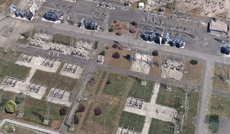

Is grass in substations an issue or concern? Anything that needs to be done differently during the construction or planning phase if its anticipated?
Seems to be a thing outside North America. thread238-440339
More like the golden standard to be honest. I can't figure out why though. I see no advantage from my limited understanding.
Benefits: Less herbicide to control grass; more vegetated area to absorb rain storms; perhaps easier to drive on.
Challenges: More lawn mowing equipment that may run into equipment; Hopefully the ground grid design accounted the lower resistivity of tall wet grass compared to fractured yard rock. If it has sprinklers to keep it that green, potential for the spray from a broken sprinkler to short out a bus.
So the ground grid is more intensive, or they rely on dielectric boots? Or do they have another trick up their sleeve?
Where are these "green" substation photos taken? I have seen some photos for substations in Russia and China where it was that green. (I think these countries don't care about copper earthing grid costs since the earthing grids are made of steel there!)
Slovenia (Eastern Europe), but honestly I'm seeing it all over the world like India and South America. There are just as many grass substations as gravel substations if not more so by a substantial number.
Answers range from its the same to "grass is better"

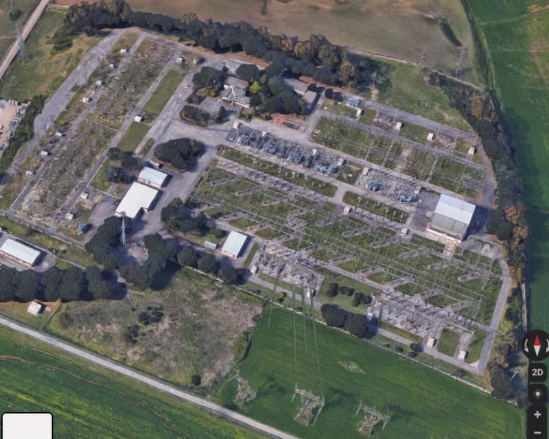

it is quite common to have "green" substation here in Italy, as well as in many other european countries.
When the substation is large, the earthing resistance is very low, so that it is not an issue to fulfill the safety requirements for the earth grid, also in presence of grass.
Just a couple of examples, some aerial photos from google.

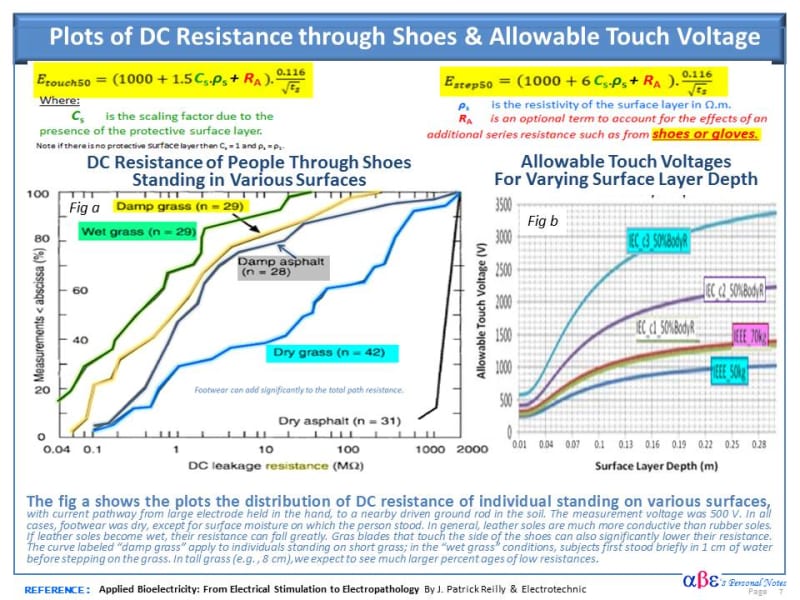

Hi Mikebrook
The amount of metallic conductor buried in the soil depends on what standard is adopted.
For Instance, a typical case following the IEEE 80, is to assume that the shoe resistance plus ground contact resistance is with barefoot (R=0) and a surface layer of 4"-6" of crushed rock with 3000 Ω.m. However, the British and other standard assume for example 4,000 Ohm for footwear resistance. This provides closer performance in term of the amount of metallic conductor embedded in the ground.
There are other practices that use a fix resistance with shoes that varies from a few 100's Ω to MΩ's.
A glance at the impact of a person step on top of a surface with grass with shoes is indicated in the illustration below. Notice that some of the grass curves are comparable with asphalt rated for 10,000 Ω.m (3 times larger than crushed rocks). Also, some information related to step and touch potential equation and graph following IEEE and IEC Std.
I hope this help.

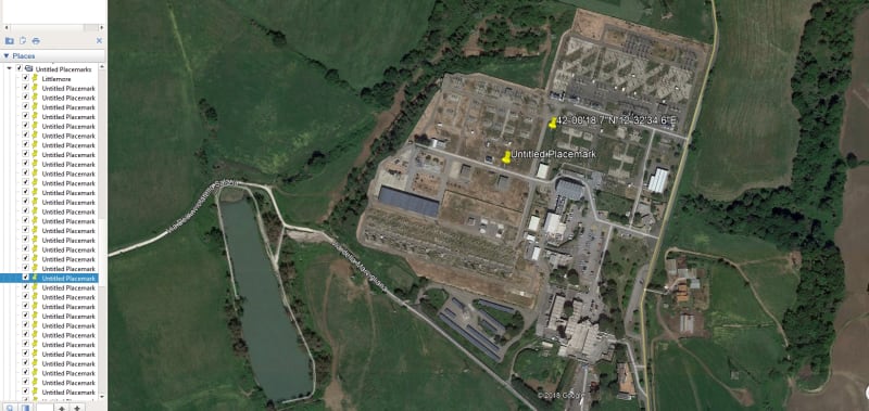

I'm curious how much copper those Italian Substations have vs the same IEEE equivalent.
@FPelec: Do you have the coordinates to the first top pic? I'd like to measure the size and compare to an equivalent sub in the US.
Mbrooke,
the coordinates are 42°00'18.7"N 12°32'34.6"E.
In large substations the earthing resistance is low enough to avoid significant issues on touch and step voltages.
Generally, a 20 m x 20 m mesh is adopted. Equipment is generally grounded by connecting it to 2 different points of the ground grid, so that adopting a larger meshing would mean to increase the length of the grounding connections.
The earthing systems are designed according to CENELEC 50522 standard, which in turns is based on the current-time and voltage-resistance curves of IEC TS 60479-1. Considering the typical fault clearing time of 0.5 s and 1000 Ohm shoes resistance, it is quite uncommon to have problems inside large substations.
It is more usual to have some issues at the substation boundary, at the edges of the earth mesh or even outside the substation (induced voltages on third-parties).
