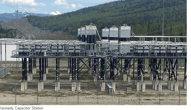

I once worked on a project installing capacitor banks in series with a 500,000 volt transmission line to offset line reactance and increase the capacity of the line.
The individual capacitors were 17000 Volt rated. The individual capacitors were connected in series/parallel to get the needed current and voltage ratings needed.
In the picture you can see the stacks of capacitors mounted on insulators and stacked three high on smaller insulators.
The entire platform for each phase is supported on the large vertical insulators.
Three phases and six platforms and we only broke one of the vertical insulator strings during construction.
