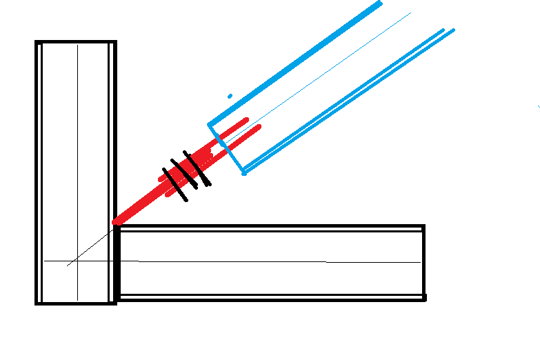

I have a new project to design bracing for an existing building. The force in the bracing is Cf = Tf = 103K... big forces!
The problem is that the gusset will be secured at the centroid of the resisting beams and columns because there is an existing masonry wall located to the centerline of the connection. The EOR want me to design the connection for an HSS 10x4x0.5 (located at the face of the wall), welding the HSS to the face of the gusset, creating an eccentricity of 2" (from the HSS) + half the thickness of the gusset.
I've designed it using elastic combined stresses, based on a Whitmore width for compression. If it weren't for the compressive load, I'd have used the plastic section. I'm looking for some comments how others would design this for the eccentricity. I've suggested going to plate that is roughly 1"x12", in lieu of the HSS, to minimise eccentricity or possibly using the existing masonry wall for lateral forces.
The forces at each end would cancel? What is the stress condition at the junction of the gusset and the HSS? Wouldn't you have to transfer part of the moment load from the centroid of the HSS to the gusset of the or just strictly by shear? Wouldn't the moment be at least the shear x half the thickness of the gusset, then?
That is the Whitmore wide for compression?

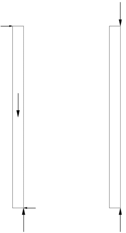

The model on the right reflects how your brace will be loaded, correct? If so, then yes, there is no shear in the brace, and no out-of-plane shear will be delivered to the gussets at the ends.
You can design the gusset for weak axis moment, but you don't need to to satisfy equilibrium. If you choose to design the brace for the entire moment and the gusset for axial force only, you would technically have a moment at the brace-gusset interface equal to P*(tg/2), but that's often neglected in the weld design.
Whitmore width is 30 degrees if you need the gusset to behave elastically at design loading, but if you can tolerate some yielding it can be as high as 45 degrees. See this paper: Link.

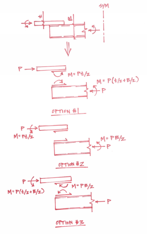

The eccentricity between the line of action at the gusset and line of action at the brace (gusset thickness / 2 + brace width / 2) creates a free moment that has to be resisted somewhere in order to satisfy equilibrium. The elastic force distribution will proportion this moment to each element in the system based on its relative stiffness. If you can allow (i.e. detail) the system go plastic, you can choose any force distribution that satisfies equilibrium based on the lower bound theorem, so you are not bound by the elastic solution.
Deker, thanks for the follow up. I think we're on the same page here. I agree that the brace would likely resolve majority of the eccentricity.
human909, if the brace is able to resist some bending, in terms of both strength and stiffness, then the gusset plate sees direct shear coming from the welds to the HSS...which means the plate only sees an eccentricity of half the plate thickness. If in another case (this is purely hypothetical), the opposite end of the brace could not transmit any shear (roller in two-directions), the end of the brace in question could not carry any bending moment...forcing the beam and column to resist 100% of the eccentricity. This would put significantly more bending in the gusset.

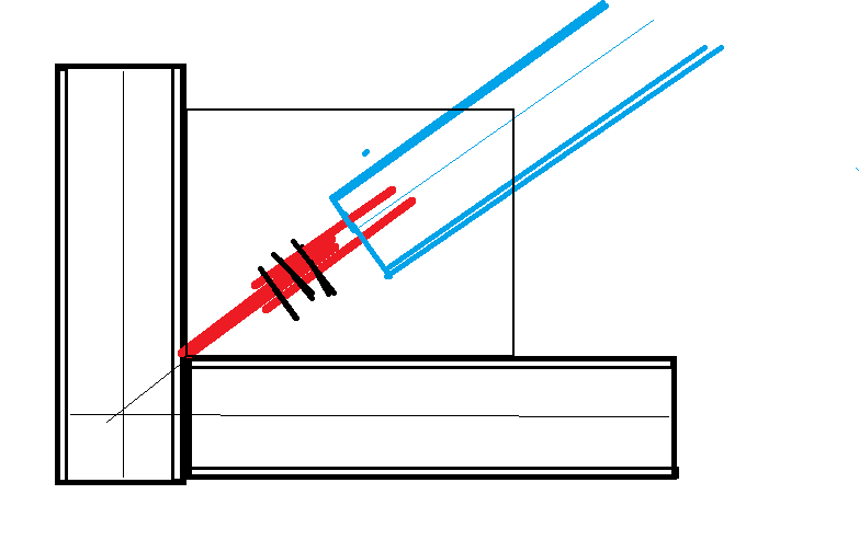

The EOR wants it thin so the gusset doesn't transfer moment to the connection. The thicker the gusset, the greater moment is transferred to the connection. I've seen gussets buckle under compressive loadings. He doesn't want to take 'ownership' of the gusset and simply give me a thickness to connect to. That was my original solution when I came up with a conservative thickness. He wants me to design the gusset. He's not happy about me stipulating that the strength of the existing beam-column combination has not been checked. Just cannot seem to 'win' some days. [ponder]
Sounds like the EOR wants you to design a perfect hinge at a point that in not eccentric to the beam/column. That is a tall ask.
Something like this could work if you can keep the boltline non eccentric to the beam column, but would be quite an unusual approach to connect things.
Something like... his concern is the moment in the other direction:
human909: Check out the FBDs below and see if it clicks. If there's sufficient ductility in the system to allow force redistribution, any of these options are valid. The elastic solution would likely fall between options 1 and 2, so either of these options could produce an efficient design. Given the proportions discussed in this thread, option 3 would be irrational (though still valid) and would result in a very inefficient design.
Deker those are some sexy FBDs. Thanks for that.
Thanks Deker for those drawings, above an beyond in your assistance. It has now 'clicked' for me.
