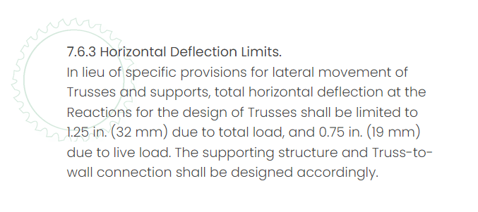

The ANSI/ TPI 1 has a code section on this very subject. It is a bit grey, over conservative, and a mistake in my opinion, stating that a truss
can horizontally deflect 1. 1/4 inch and be 'fine'. I think this is laughable.
