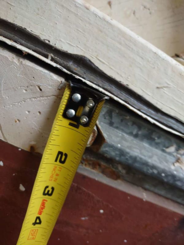

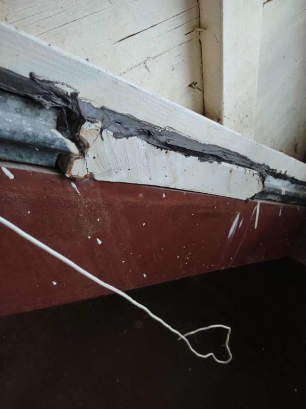

I have an existing mezzanine that I need to evaluate the capacity of. The mezzanine uses what looks like prefabricated gypsum panels that are supported by open-web steel joists. The panels are approximately 2" think and span 3'-6" +/- (steel joist spacing).
Does anyone have any information on these panels and their load capacities?
view from underside
view from top of mezzanine
cross section view of panels
I ran into these same panels for the first time as well maybe two weeks ago. Mine were used for roof framing.
There is a similar product apparently still available by Martin Fireproofing. They have load tables (attached)
The Gypsum ones were possibly by a company called US Gypsum. I did not have luck finding load tables on-line. (2015 article attached)they mention a US gypsum specification guide 1971.
Those look like a Bulb-T system.
Not sure they were ever approved as flooring, they are a bit low capacity and don't feel very ductile to me, then again, neither does Tectum. I know at one point I found some information on them, including some diaphragm testing? These are more of a roof plank system to me.
A few links -
Diaphragm strength:
