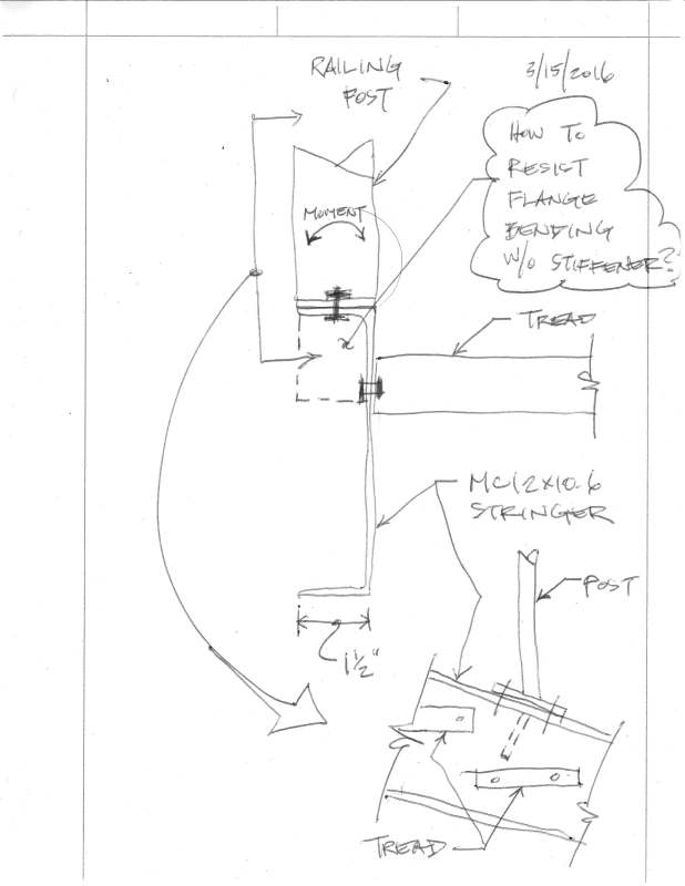

I'm right in the middle of similar calcs so thank you, Stenbrook, for reading my mind. And thank you to all who have contributed well-thought-out responses. My case has 1.5inch square tubes for posts so those are fine, but the connection to the channel flange below has been a thinker. Any suggestions on an approach to make that connection work without adding a stiffener as shown in the attached?

I also ran into problems with direct mounting on the top of the flange without a stiffener on all possible channel sizes and with some types of clips direct welded to the web of members with all types of web thicknesses. As a result there's a stiffener on the standard detail with a note that it's UNO on the drawings. If someone wants to show that they work without stiffeners for some cases, they're free to do it, and I did it on our standard stair detail, but a standard detail needs to work in all cases.
