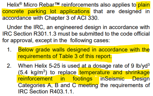

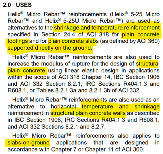

I just read over the ICC-ESR for Helix. Seems like its scope is limited to T&S for plain concrete and slabs-on-ground.
Which codes recognize steel fibers as flexural reinforcement? None in NA, and I have a hard time believing it's buried in Eurocode somewhere.

That being said, the ICC report saying that it's used in the design of structural plain concrete doesn't mean it isn't a rebar alternative, just that it is designed under those clauses. It would make sense, as it's more of a homogeneous material with a consistent linear response than the very non-homogeneous response of traditionally reinforced concrete. Traditional rebar design has your tension lumped at the rebar points. This has it spread through the cross section, and presumably has less ductility. So it's a triangular stress distribution, or something similar.
That being said, I have no idea what their documentation says with regards to the tensile stress it gets you to or whether than makes the plain concere methodologies comparable to more traditional strengths.

Doing some quick math on the ICC report, I think a 12" slab with maximum dosage gets you 35kN*m per meter length or 95kip*in / ft. That's a few times less than a reasonably reinforced slab, but it's also not nothing. Given that the actual material costs of concrete without the labour costs for bar are pretty low, that might be useful in some situations.
I still probably wouldn't use it.
