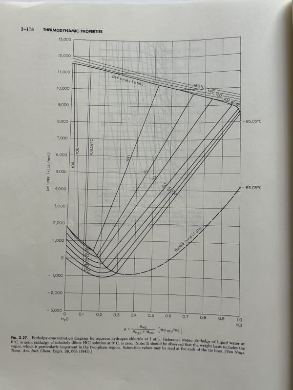

I have doubt about heat of dilution
32% hcl dilution to 10% how much heat generated please suggest and provide heat of dilution chart of hcl
It's in Perry's Handbook.
Good Luck,
Latexman
This is not clear image please send me pdf
I have calculated heat of dilution of 32% hcl to 10% hcl please suggest enthalpy of 32% hcl concentration and 10% hcl concentration because I am unable to understand curve
I edited my post above. I deleted the low resolution picture and added a much higher resolution picture.
Show us your work and we will reply.
