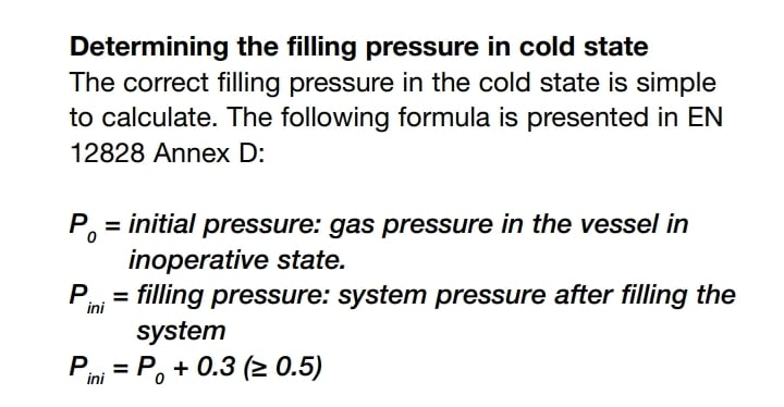

Dear experts
I have read some manuals from different expansion tanks' manufacturer and they have mentioned the expansion tank air side pressure should be 0.3 bar higher than the static pressure of the point to which the tank is connected.
If the air pressure of the tank is the same static pressure that the tank is connected to then likelihood of filling the tank with water is too high although the water has not been warm or expanded.
The same formula from CALEFFI company
Do you apply the above formula into practice or only charge the expansion tank just the same static pressure as the point it is connected to?
