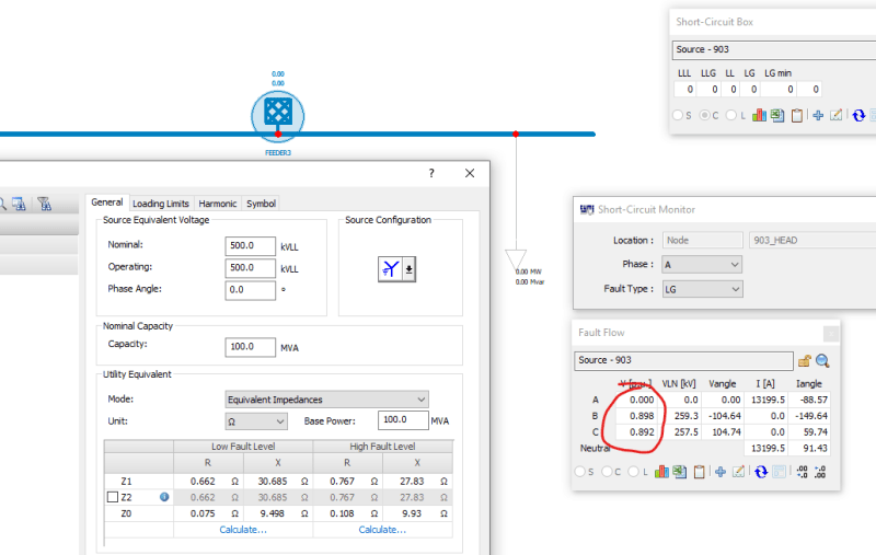

I have an effective grounded 500kV system. If I apply a single phase to ground fault, I expect the fault phase to ground voltage to be 0 at the point of the fault, while the other two healthy phase to ground voltage to increase (amount affected by system grounding).
However the simulation actually shows the healthy phase phase to ground voltage also decreased at the point of the fault. Anybody have an explanation to why the voltage decreased instead of increase?

no, i just have a source equivalent (shown in the screenshot) and a fault right at the source, nothing else is modelled.

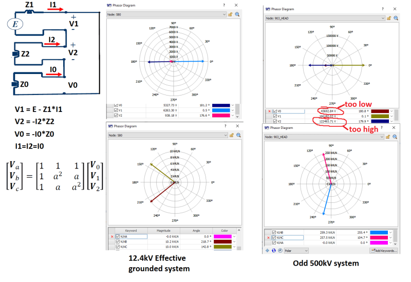

ok PSCAD support was no help, but at least I understand mathematically why the healthy phase voltage can drop during SLG fault.
For phase A to ground fault, connect the sequence network in series blah blah, we can calculate V1 V2 V0. Typically Z0 is higher than Z1 (also satisfying X0/X1<3), this leads to magnitude of V1 > V0 > V2. Also V0 and V2 are in phase while V1 is 180 degrees out of phase. These sequence vectors results in a typical effective grounded system voltage we expect. (see diagrams below)
However for my source equivalent shown up top, the Z0 is much lower than Z1, this results in higher I0. When you calculate V1, V2 and V0 again, now magnitude of V1 > V2 > V0. Converting back to phase quantity, the Vbn and Vcn will decrease under 1 pu.
I got these source impedance from the Utility, they said it was accurate and I have to assume it is. Even tho I can explain the voltage drop mathematically, I still can't come up with an intuitive explanation.
Bonus point - i tried this is multiple modelling software and they got the same result. I have to assume system actually behave like this in real life. Folks here can run the numbers with the source equivalent in the original post to verify.
