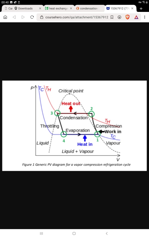

I’d need to calculate an heat exchanger that cools compressed air.
Normally these calculations are realized considering dry air.
In this case I need to consider relative humidity of compressed air.
Therefore, if the air touches a surface under dew point temperature, would generate condensate.
Please, does anybody knows any correlation I could consider for this specific case ?
Can anybody recommend me any publication I could refer in order to study the physical model ?
I thank you in advance for any help

Compressed air is entering the heat exchanger at following conditions
Entering @194F, 135 psig 100% RH
Outlet @86F
Therefore the outlet temperature is lower than inlet temperature and therefore saturation.
I deem that we are moving form 2 to 3 and then down to saturation line.
Please, is my interpretation correct ?
Do you know how to realize a calcualtion at these conditions ?
Thanks in advance
You have to include the cooling of the water content in the air.
This chart for air at various temperatures and pressures, with example,
Be sure to include the latent heat of condensation of the amount of water that condenses, as it must be carried off by the coolant stream.

Hello all
I would like to thank you for your kind answers.
I will try to answer to these questions, defining also my issues.
Unfortunately, I am still stuck in defining the mathematical model.
Staring with answering or commenting your posts.
@1503-44
Do I simply consider the max water content at inlet conditions and consider that all the content condenses?
@MJCronin
I need to consider wet air and not dry in order to calculate the condnesate part and how much condensate to drain
@georgeverghese
My problem is indeed to determine the b) part, so that I can utilize your equation.
My problem is as follows.
How can I determine if and when the condesation will occour ?
I would expect when the temperature will be lower of the dew point temperature.
But how to determine this point ?
Could you maybe recommend me some literature concernin this topic, maybe there are already some standardized methods ?
The water content at discharge conditions will remain in the cooling air stream carried off.. The amount that condenses is the difference between the content at inlet conditions minus the content at outlet conditions. The 1st link I posted shows water content kg/m3 at various temperatures.
If inlet temperature is 30°C, water content is 0.0304 kg/m3 , see 1st link
C kg/m3
20 0.017
30 0.030
At 20C it is 0.017 kg/m3
So 0.030 - 0.017 = 0.013 kg/m3 condenses
