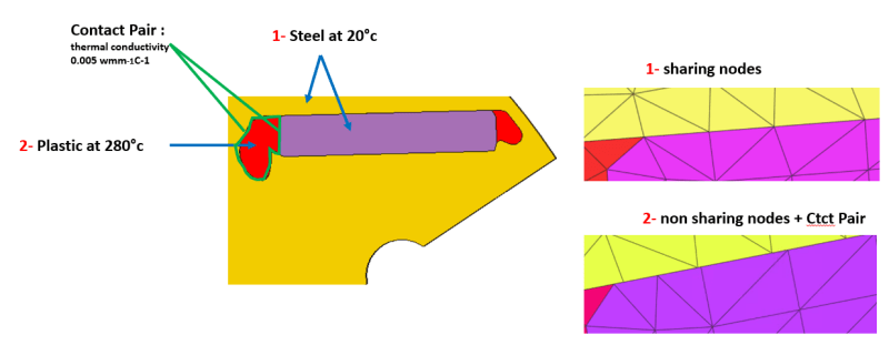

I'm doing a thermal analysis with Abaqus as dicribed below:
1- The initial temperature of the steel is 20°C
2- A molten plastic at 280°C is injected
what is the most appropriate modeling method:
1- use a sharing nodes in the interface in this case how can i define the thermal conductivity of materials (I don't think that Abaqus detects it automatically)
2- use a non share nodes and and connect the parts with Pair contact where I can add the thermal conductivity of material ? for this case i'm confused which one to use at the interface between plastic/steel ? the thermal conductivity of Plastic or steel??
It's usually best to just use tie constraints in such cases. They ensure an ideal thermal connection. Contact with gap conductance is used mostly when the thermal resistance of the interface has to be modeled for some reason (e.g. due to the presence of an air gap) but the value must be obtained from tests or literature.
Thank you for your reply;
Should i define the conductivity with the tie contact? If it's the case wich one must be used (of plastic or of steel)?
And how can i define the initial temperature, using a BC or initial condition or it's not necessary to define it?
Tie constraint doesn't require conductance definition. It always allows for unresisted heat flow as if the mesh was continuous.
You should define initial temperature (as an initial condition) if you want it to be different than 0.
