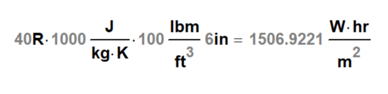

As a first approximation ,the time needed to bring the surface to 40F would vary by the square of the distance from the W/G tubes to the surface . There may be 1940's era graphs of a similar problem solved in the kreith heat transfer texts.

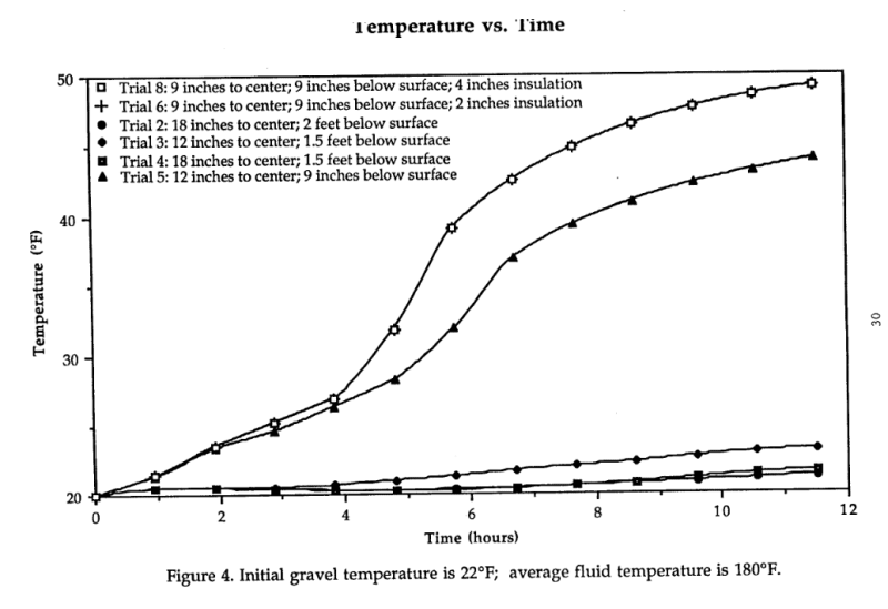

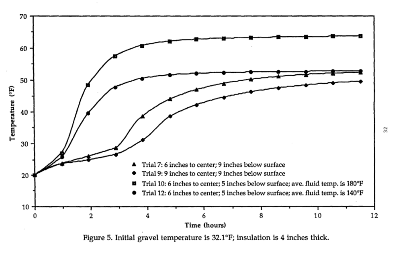

Hi Everyone, I just wanted to post an update and thank everyone who weighed in on this thread.
We're going with a 6" maximum tubing depth. For me, that's the best tradeoff between system performance and eliminating the possibility of damage from post-installed anchors. I know some will disagree, but in this case the customer can spare the time/energy required for startup and this keeps rogue drill bits from killing the system prematurely.
User "IRStuff" above posted about calculating the "best-case" time to heat the concrete. I ran these calcs for the design conditions and came up with 1.8hr for a 6" slab, 3.8hr for a 12" slab, and 8.1hr for a 26" slab. Again, that's ignoring ALL losses, but a helpful benchmark anyway.
Actually calculating the transient effects was unfortunately too much of a problem for the amount of time I had to invest in this. I did, however find a 1995 Alaska DOT paper investigating hydronic heating of roadways in which they set up test rigs embedded in gravel/asphalt. I'm attaching some of the relevant graphs below which give the only decent empirical data I was able to find on the subject. The full report can be found at:
