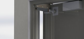

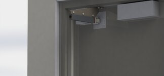

Your analysis is spot on. The plant will be going through an HVAC rebalancing in the not so near future to be the permanent fix for this. In the interim, I've been tasked with developing a stop gap device that provides assistance to getting these doors open (we had a small female worker get stuck in the plant due to not having the strength to open the door).
I learned on Thursday the NFPA-101 Life Safety Code requires the opening of any safety door to require only one motion. That means the device I showed would not work because our door has a crash bar that has to be utilized.
I'm currently developing a piston that will be installed towards the top of the door that will hopefully provide enough force to help push the door enough meet the 30 lb force requirement.

For anyone still interested in what was the solution to this problem, the attached pictures is what I proposed. Its essentially a piston that will push on the door while the personnel are engaging the Push Bar. Other concepts were proposed but due to NFPA-101 codes, majority of them were non-starters.
