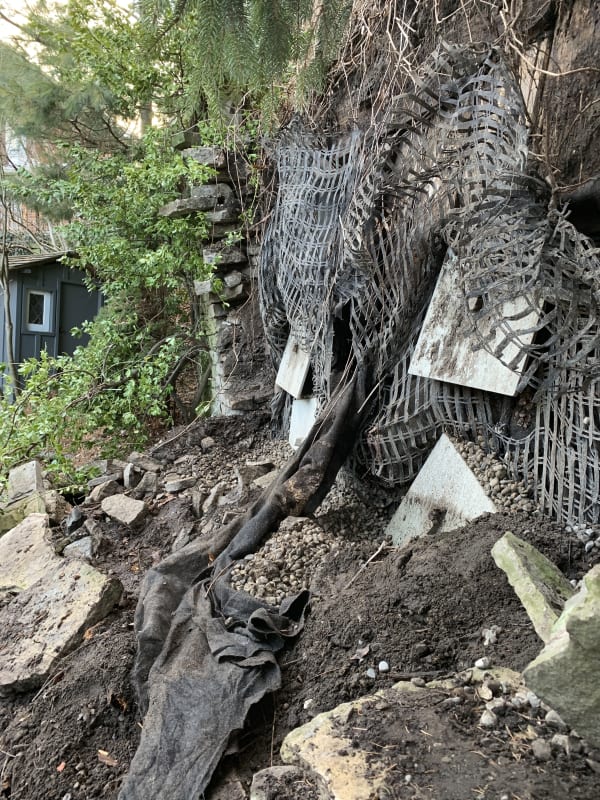

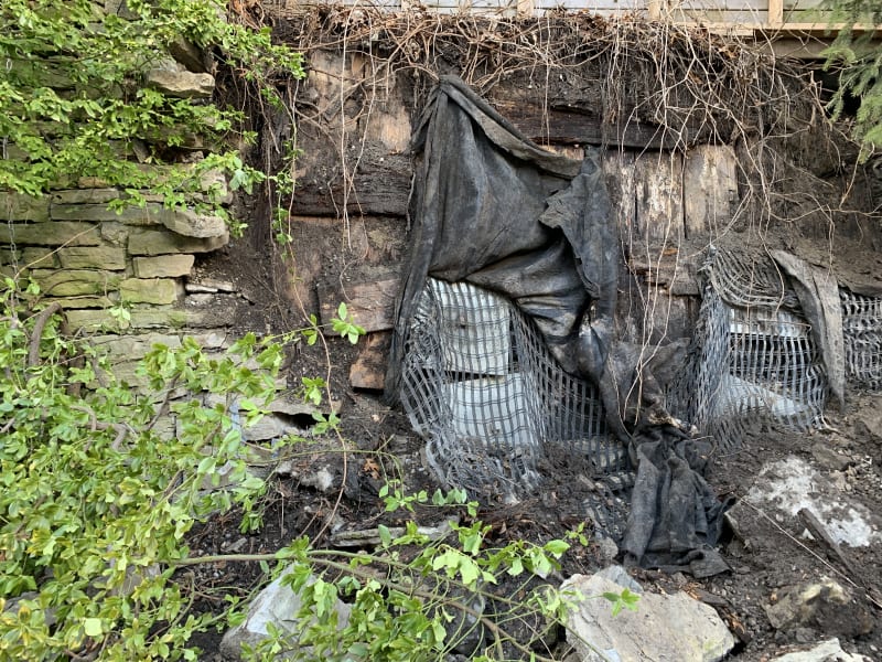

My apologies for the lack of details, I was running off to a site. I have attached a photo below. Some clarifications.
The drystack wall does not appear to be retaining in any fashion. Its just a stone wall infront of an embankment that appears to have been stabillized with helical ties/anchors. The tie backs are not attached to the stone wall in any way. See picture below which shows the metal plates for the helical anchors. You can see how they are displaced vertically and have rotated.
The configuration and order of the components of the wall is as I described above and hopefully will be more clear with the photo.
I dont know anything about the helical anchors except that they have a 18x18x3/4" plate attached to them and the drawings indicate they should be torqued to achieve the design load. No indication of minimum depth of installation
Unfortunately, the photo doesn't help explain very much. How do you know the wall is failing? I see a pile of soil and some big rocks in front of the wall but don't see any clear evidence of wall failure. Maybe the failure is hidden behind the black fabric? Have wall movement measurements been made? Maybe the wall just looks ugly and was built ugly.
Helical anchors cannot be installed through rock without pre-drilling or coring holes. These anchors may be small diameter anchors that were installed wherever they could get the anchors in between the rocks. There may not have been any anchor displacements. The anchors may have never been installed in the locations shown on the original plans. The large 18 inch plates are used to span across any space between the rocks so that the anchors are bearing on and laterally supporting the adjacent rocks. Someone may have hung some geo-textile filter fabric and what looks like geo-grids to prevent soil from falling out from behind the rocks and through the spaces between the rocks.

PEinc I don’t really understand your post. I know the wall has failed because the dry stack stone is lying on the ground in front. You can see the remaining stone wall in both pictures.
Also I mentioned in both my posts that the anchors don’t tie back the stone wall they appear to tie back the soil and the stone wall just sits out front. the way in which the soil was stabilize behind the stone wall does not make sense to me. How can 6 steel plates, poly mesh and geofabric hold back the soil?

I see what seems to be a structure beyond. Is there surcharge loading or trees just above the "wall", and I use the term loosely here?
Those plates look like the type used in soil nailing, but these should be combined with shotcrete and rebar, not a jumbled rock mass.

Ok so to me it looks like they tried to repair the previous failure using soil nailing and wood planks and then just matched the face of the wall without connecting anything. Were you able to see if there were large voids behind the wood planks anywhere? To me it looks like the repair may be holding but that the dry stack portion failed (probably from hydrostatic pressure from the recent rains) due to an insufficient design. It should have been shotcreted like msquared mentioned or tied in somehow.
Yes this is what I am saying. It appears that they are using the 1x10 vertical wood planking as their « structural wall » in which the soil nails /anchors are attached to. There is no whaler to tie this vertical wood planking together. It makes little sense structurally how they were holding back the soil and the drawings were stamped by an engineer. I didn’t know if I was missing something and if this type of soil retaining system is common.
I did not see any large voids behind the wood planking though it was difficult to see. What really stood out was how the upper soil anchors had move down 3 feet or do and that they appeared to have pulled away from direct contact with the soil Would it be unusual for a contractor to install the anchors so dimensionally off from the drawing?
Above the wall is a wooden fence and yard. There is a tree maybe 25 feet from the wall on the upper property
Sweever, from the photos (without blowing them up), it looks to me like some of the 18" plates are bearing against stones and or gravel. Maybe I am wrong. Maybe what looks like stone to me is actually the boards you described. I really can't tell from the photos. The gravel under the 18" plates could be packing to provide full bearing beneath the steel plates that are not parallel with or bearing directly against the stones or boards. If there are no stones remaining around the anchors, the anchors could easily have bent downward a few feet due to additional wall collapse. In any case, if I were trying to fix this "fugly" looking wall, I would consider first thickly shotcreting the front of whatever is still standing there and then, starting from near the top of the "wall," install weep holes through the shotcrete and some drilled and grouted soil nails. (Yes, these would be more expensive than helical anchors, but how have the helical worked so far?) After most of the wall is shotcreted and nailed, I would clean up some of the soil and fallen stones at the base of the wall before shotcreting and nailing the remaining, lower portion of the wall. Consider shotcreting and nailing some of the remaining, leaning stone wall to the left of the failed area. I would not use more helical anchors. I have nothing against helical anchors. I have designed them for many projects.
I am not trying to fix the wall, just provide an explanation as to why it failed. To me the way the original engineer tried to retain the soil was bound to fail from the start.
