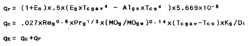

The fire tube consists of two parts. The first part has a 1.1 m diameter and the return tubes (or clusters) with 273 mm diameter. I used simple heat transfer equations to calculate the heat flux over the first part. I divided the first part into three segments, and the total heat flux (convection plus radiation) of every piece is as follows (the length of the straight fire tube is 9 m):
1) First part has 18033 Btu (th)/hour/square foot/F
2)Second part has 15050 Btu (th)/hour/square foot/F
And 3) Third part has 12442 Btu (th)/hour/square foot/F

These values you quote are heat transfer coefficients ( U presumably), while the design values I referred to are heat flux values. Have your values converted as required, and compare them to the values in Campbell.
Else, you can work out if your heat flux values are acceptable by computing the OD surface temp in the first part where flux values would be highest - I would suggest keeping the surface temp at <90-95degC to prevent boiling which would otherwise lead to excessive vaporisation loss, assuming there are no constraining upper limits arising from potential scaling of the firetube OD due to dissolved Ca, Mg salts in the water.

I used the formulation to calculate two heat fluxes (Radiation and Convection). I used the formulation to calculate two heat fluxes (Radiation and Convection), and they are heat fluxes, not heat transfer coefficients.
The limits for heat flux are articulated by API-21K as follows:
The typical surface temperature is estimated by "PLP E-8-2003, Indirect Fired Heaters-2nd Ed-Rosen."

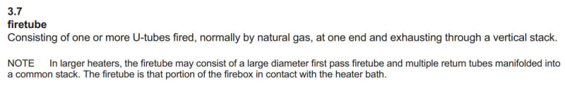

In API-12K, it is articulated that "In larger heaters, the firetube may consist of a large diameter first pass firetube and multiple return tubes manifolded into a common stack. The firetube is that portion of the firebox in contact with the heater bath.

The formulas you've pasted across from API 12K are indeed heat flux expressions, so the values you quoted earlier should be Btu/hr/ft2 and not Btu/hr/ft2/degF.
Okay.
The first of these expressions, a modification of the Stefan Boltzmann eqn, is identical to equation 5-155 in Perry Chem Eng Handbook 7th ed, with the appropriate correction factor (1+ε1)/2 included to account for the gray firetube inside wall. While the second is the familiar Dittus-Boelter eqn. Presumably you've used correct values for each of these.
Calculations for surface temp involve iterations, you should manually check / verify some of these values, which you can do using first principles also. The overall flux values indicate it would be better to use a slightly larger surface area to keep overall flux value below 12000 btu/hr/ft2. What does API 12K or Campbell say the max skin or film temp should be for this application ?
Its been many years since I worked on these heaters, and the largest was 84inch (I vaguely recall) for NIOC, which is much smaller than this unit of 180inch dia.
Both these expressions require a value for Tcs, which can only be derived by several iterations for each section - have you verified at least a few of these values ?

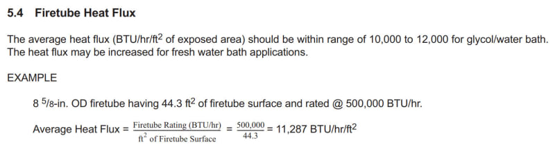

Found the 2009 edn of API 12K on the internet. It states the additional upper cross sectional heat flux to be 15000 btu/hr/in2 - have you verified this for the hottest first pass at least ?

Checking for heat flux rate based on cross sectional area:
a)DN 1100 first pass firetube = 11581btu/hr/in2 - okay
b)DN273 return pass tubes = 14460btu/hr/in2 - okay
As mentioned earlier, overall flux rate based on linear area is a bit high, pls keep overall rate below 12000btu/hr/ft2.

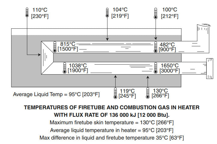

At the Tcs values you've quoted, for the most part, firetube OD film temp would be higher than 100degC, so heat transfer mode from the outside surface would be subcooled pool boiling, where the tube surface is blanketed by vapor bubbles, and not by natural convection in the liquid phase. Check that these Tcs values are calculated based on one of the commonly used pool boiling htc estimation methods, such as Foster Zuber (for the DN1100 section) or the Palen Small (for the close pitch DN273 return tubes). Thermal designers would not venture to do this, as long as they comply with API 12K upper limits, but it would be good to get some confirmation with these more detailed estimates.
Checking for linear heat flux compliance to 12K ( q<12000btu/hr/ft2):
Linear area DN1100 section = 31.1m2, DN273 section = 100.3m2, total = 1415ft2, which makes q = 12056btu/hr/ft2 - okay
It clearly looks like this heating bundle was set up to meet these 2 upper bounded heat flux limits in 12K, so the heat flux values you published earlier are probably max possible values. Which means actual Tcs profile for 10MW duty will be lower that you've published, and fuel gas demand will actually be lower than predicted by API12K (ie heater thermal eff is somewhat higher than predicted by 12K) . So I'd say there is no need for any increase in firetube surface area.

Dont think I need to see these iterative calcs for Tcs. You have complied with heat flux criteria in 12K, so the rest is just icing on the cake. But as the thermal designer, you should take an interest in these detailed calcs. The mode of heat transfer from the firetube OD surface should be one of those for pool boiling, not natural convection in the liquid phase. These are iterative and laborious calcs, but you can learn a lot from this exercise.
At 95degC bulk temp, you would most likely need to install a "water saver" at the top of this heater shell, to minimise vaporisation losses.
