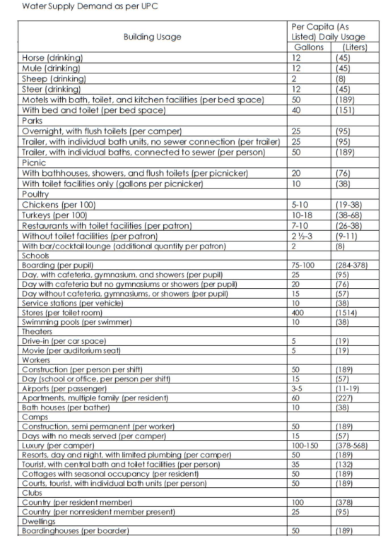

I want to know where can I find domestic water used of per person per day in differernt types of buildings, for domestic water tank size .

Search engines are great.
Use "domestic water use per person per day <insert country of interest here>"
Examples: (units are litres/day/person)
USA = 227. China = 185. Germany = 123. South Africa = 235. Russia = 248. Iceland = 200.
This is a total of all personal usage - which means some at home, some at work, and (maybe) some at a restaurant or hotel or other venue.

In fact, what I want is something like this table, which specifies the water needs of each building for the corresponding personnel.
This form was found on the Internet, and I would like to have a more authoritative department or agency to publish it

I think universal plumbing code donot have this table.
Well at the top of your list it says "as per UPC...."
Anyway, sizing a tank is not a precise art. The actual use of the building makes a huge difference.

It appears that you are in Iraq. The water usage is probably substantially less there.
