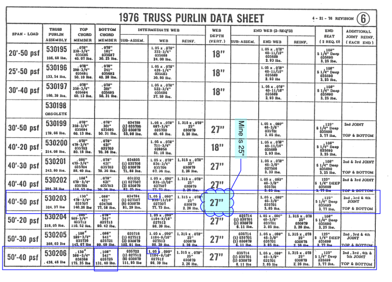

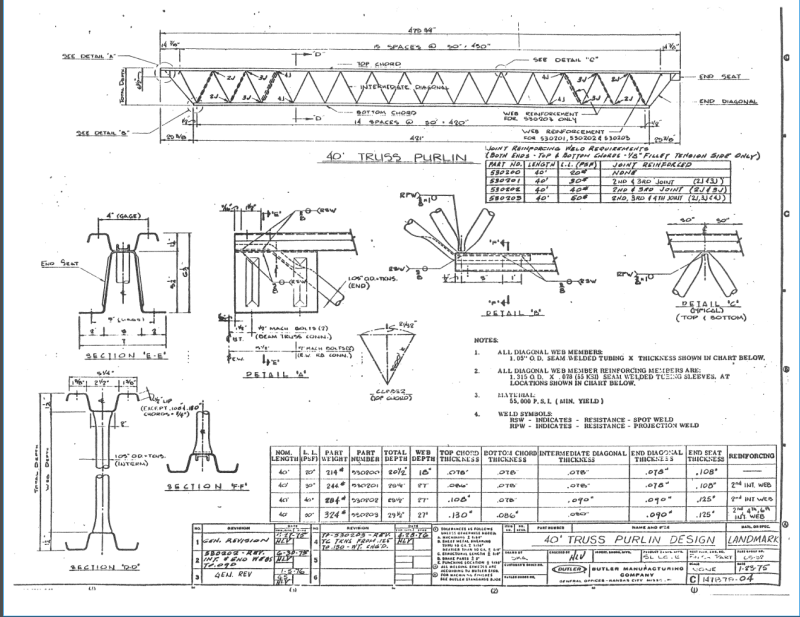

I also came across this Butler joist truss purlin catalog from a friend. Some of the bottom chord thicknesses and web members thicknesses are what I measured but the depths are not. I wouldn't think that the joists would be overstressed sharing 1700# across three joists but they are. I'm basing analysis on 20psf DL, 30psf LL. based on the attached pdf. see blue box for 40'-50psf. But the joists I have do not have end reinforcing as specified in the table and my joists are 25" tall. This is not making any sense.
Your 25" measurement looks like the truss depth, not the web depth. See section D-D.

I received some documents from them but one is for a 30' joist and one for a 40'. I also received the same table I posted above. None of this makes sense. The last column of the table indicates that reinforcement of the web members and joints is required for 40' spans, except for 20psf LL. The web members size for 40'-20psf is 1.05" consistent with what I measured. The bottom chord thickness for 40'-20psf is indicated as .078" and I measured .108". The .108 is the bottom chord thickness for the 50'-40psf joist. Is it possible they mixed and matched?
The analysis shows that the 40'-20psf joists need to be fully reinforced for shear and moment for placing two 300 pound point loads on the joist (near the middle of the span), but no reinforcement is required for the same loading for a 40'-30psf. That doesn't make sense that there would such a large difference between the two as far as reinforcing is concerned.

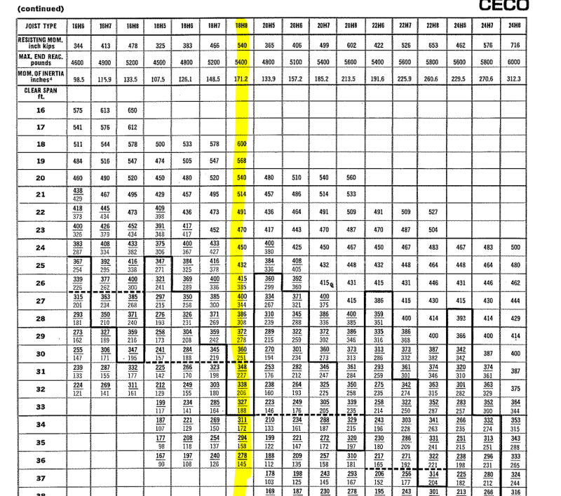

I wanted to provide an update on what I've done so far:

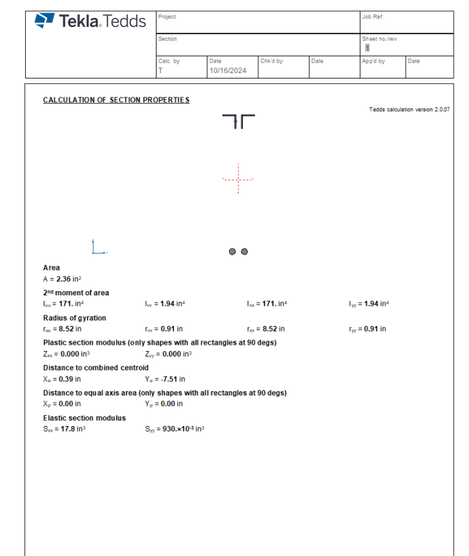

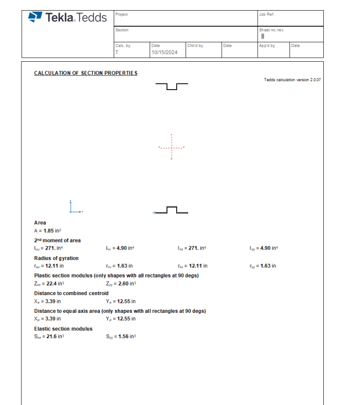

I used TEDDS to calculate the Ix of my joist using the section builder:
Then I did the same thing for 18H8 out of the 1967 Ceco catalog, for which I have the section properties of the chords as a sanity check:
The Ceco catalog has the same Ix as calculated in TEDDS:

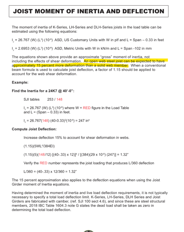

The SJI manual has the following equation for calculating Ix.

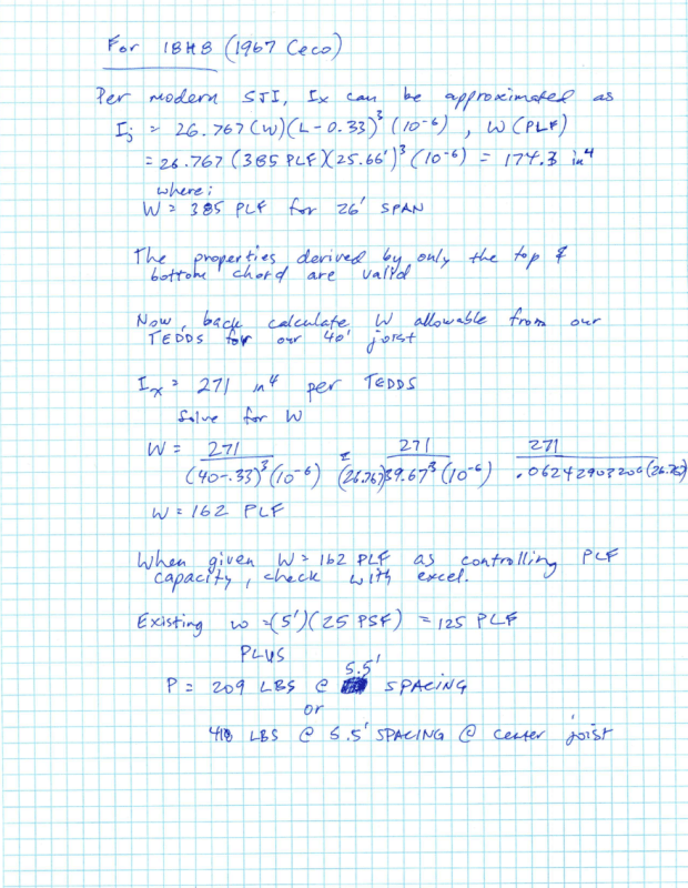

I then did a hand calc to calculate Ix for the 18H8 using the SJI equation. Calculated as 174 in4, pretty close:

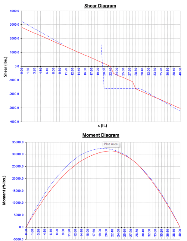

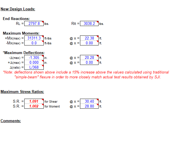

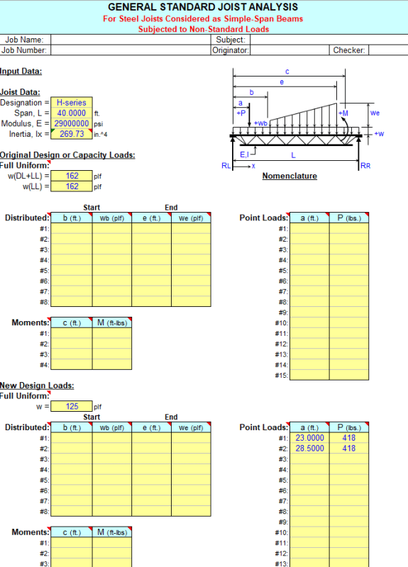

Our W is 125plf (5psf DL and 20 LL, joist spacing of 5'), while calculated allowable PLF based on SJI equation is 162 plf. I then put these in my spreadsheet:
There is a masonry wall right below the center of the RTU that I am planning to use to carry some of the load, so the 418 point loads I'm applying are conservative.
What does everyone think about this methodology?

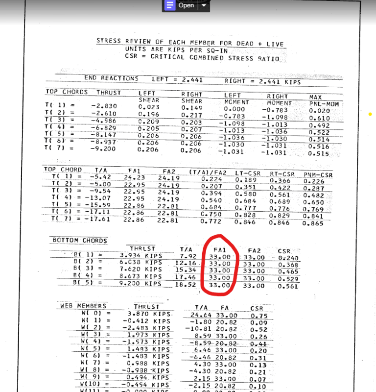

I think the only thing I'm not sure about is the Fy of the chords. I have a computer output I received from SJI for Butler joists. The properties under the "diagonals" list indicate Fy=55 ksi. I'm not sure about the bottom chord Fy, I gather it may be 33ksi from this section of the computer calculation:
I think the 33 ksi is the allowable (0.6 x 55 ksi).

As a side note, I've been meaning to post this -
This is a direct link into the internet archive (which is working again) for slideruleera's web site, so quite a few of these catalogs were contributed to the site and you can download them here. There are other threads, of course.

I know I'm a bit late, but the picture of the joist on page 1 of the supplemet document looks an awful lot like your condition. I've uploaded all I have for Anthes joists.

@EngDM I feel pretty confident these are Butler’s Landmark joists. The fastener holes in the top chord, the continuous crimped webs, and the shape of the joist seat are all characteristic of Landmark joists.
@TRAK.Structural Easier said than done, I think. These joists are super thin, funky cold-formed shapes that don’t lend themselves well to traditional reinforcement. The webs are literally just spot-welded to the chords. I don’t think they are good candidates for reinforcement IMHO.
