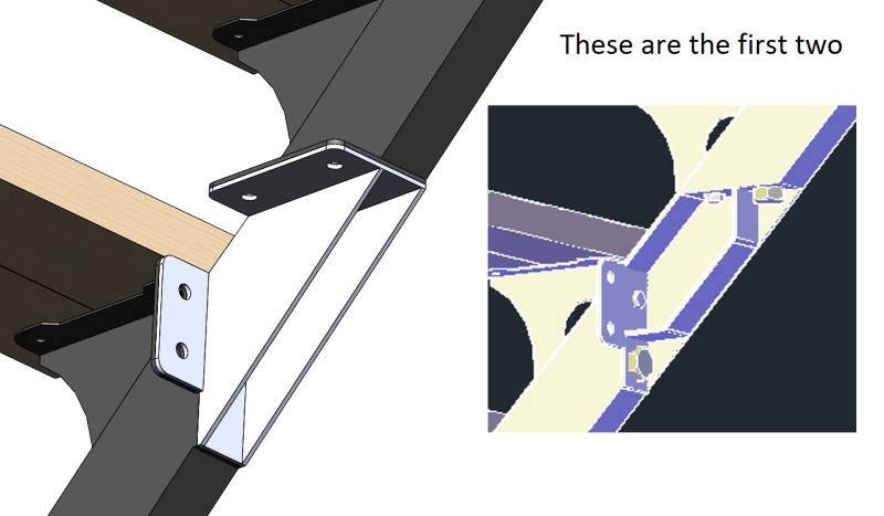

Hi! My name is Aless, I am a Colombian Junior Mechatronic Engineer. I have a passion for CAD design and applied for my first job in the matter.
I got hired by a company, however, they want to test my design knowledge.
So I was given this problem of a staircase that the company produces by blocks of 6 stairs, the way they do bigger stairs is by connecting these 6 stair blocks in series by a joint in the middle using bolts (in the first image, the bolts are in the positions of the red lines drawn over the model, there are 8 of them holding the 3 pieces).
I was asked to design 4 possible variants of this joint in the 3D software, and point which bolts are under the biggest stress and give the stress numbers.
I have read the normativity, calculated dead stress and live stress on the staircase and have already calculated which distributed load the stairs should be able to withstand and under what safety factor.
Once I have the bolt forces calculated I know I will be able to calculate stress and design variants in no time, however, the knowledge of how to find the forces in the first place escapes my memory.
They are implying this is a very simple calculation that is done by an experienced engineer in under 2 hours by hand and they won't allow me to use the software's built-in finite element analysis tool
Perhaps I just don't know which equations should be used in the first place.

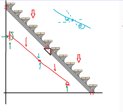

I have tried free force diagram by separating the distributed load into 2 punctual forces (Fko1 and Fko2) and calculating for the 3 parts but it gives me a system of 16 equations and 16 variables (forces in X and Y for 8 bolts), which I doubt can be done in so little time by hand and no matrix calculator.

Wouldn't it be easier for OP if the free body diagram is a propped cantilever with internal hinge (statically determinate)?
The far left end being fixed, middle as hinge, and far right-bottom as roller. With the moment at the fixed end you can compute the stresses and shear in your bolt. The internal loadings developed at the hinge being used to check the stresses of the bolt at the hinge.
I personally think that's a start.
From where I'm sitting, the main issue with the propped cantilever is, what are you framing in to on the wall? I'd set it to shear and tension, and leave the bottom as the roller (I've found most EOR's get a bit fussy when you tell them you need to apply any horiz. shear into their floor slab). Then, do the moment connection through the piece that you have control over (the splice).
Bulb - it's probably unlikely that the end condition will behave as a fixed connection (though I don't know-it's possible), and I don't think you can sell the roller at the floor at all. It certainly won't behave that way.
Easiest is probably pinned ends, check it as a single member. Then solve for the internal shears and moments at the splice to determine loads/stresses in connecting elements.
I thought OP has to come with 4 different possibilities.
The fixed end is quite uncertain but the roller makes it determinate and easier to analyse in this scenario (if it is fixed). I agree it won't behave that way at the floor.
The pinned ends is absolutely the easiest. I guess OP would need to be able to justify his/her reasons for his/her free body diagram for all other alternatives.

But the stair pieces are already designed to have 2 bolts on each joint, that makes it 8 bolts in total, each one is a little red line in my original drawing. Check the image of a middle piece I designed, you see? 2 on each side, and then 2 more on stairs to wall and 2 on stairs to floor, 8 total.

Here are some examples of the middle piece that I did.

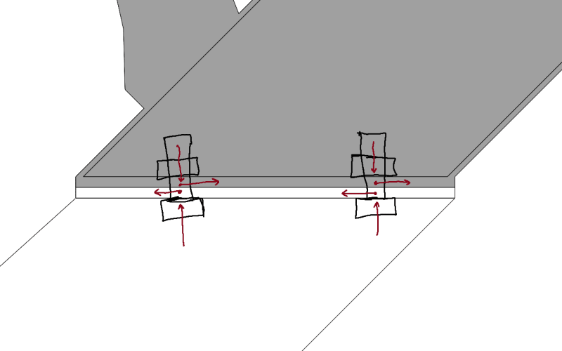

That said...is it safe to assume, when I have calculated all of them that I will be able to simply input the resultant forces on the bolt design equations as this next image shows to calculate tensile and shear stress and that would be approximately ok? Or is more needed?

At the start forget about working out the reactions at the bolts themselves. See step 3 in my recipe. Treat the whole set of stairs as ONE beam with 2 supports. The entire problem becomes simple. Lets pick pinned supports at the ends so that they are simply supported. Lets consider the force acting the the perpendicular direction only as 'w' which is w=W/[√2] for a 45 degree stair.

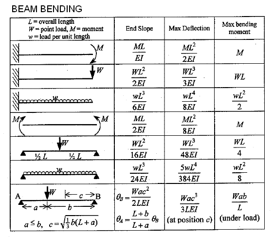

I know that for a simply supported beam the maximum moment occurs in the middle with zero shear:
M=wL^2/8.
With that information you have all you need to calculated the forces on the bolts in the middle.
At the middle you have two joints both carrying the full moment of 'M'. To calculate forces on the bolts you can assume the moment acts over the distance 'd' between the bolts and it is just:
M/d to give the tension force on 1 bolt in the joint. The other bolt carries no tension or compression the opposing compression is take by the bearing surface. So in total 2 bolts with M/d tension and 2 bolts with ZERO load.
You now have all the forces in all the bolts in the middle.
What about the ends? We have assumed simply supported so equal shear both sides. So WL/2 or wL/2 horizontally and wL/2 vertically. From inspection I see that the top bolts are in shear in the vertical direction so each bolt carries wL/4 and the bottom bolts are in shear horizontally (assuming no friction) with each bolt carrying wL/4.
