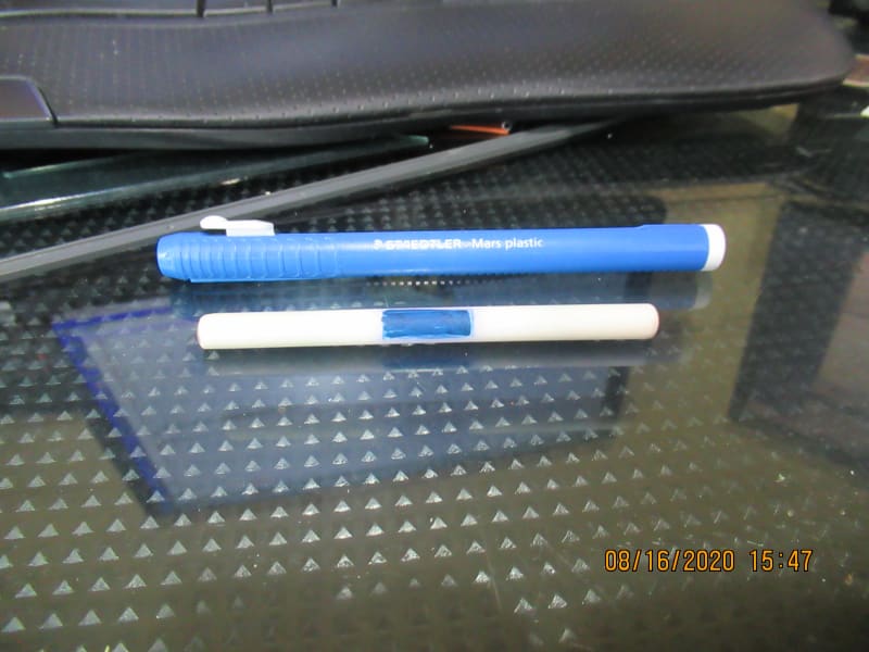

I do not know how many class hours would be devoted to this, but the list I saw in your posting is a lot to digest. My thoughts are with some others in keep the math and computers to a minimum. If all the kids can walk out with a basic understanding of how things work, that will benefit all of them. The math of column buckling at their stage is less important than why something buckles.
Here is a picture of a Staedtler eraser I have use many times to quickly illustrate a "feeling" for how things work.
Here are some examples of things that are helpful but not intense:
-Once you explain column loads for example, take the A, L, P and E that are used for how much the column compresses and have the class figure out what goes in the numerator versus the denominator. Instill the feeling more than the math.
-Not just explain Action-Reaction, have them predict simple things will fail or work depending on what you do to them. Kind of like stand on a desk or stand on a chocolate pie but not that simple.
-Load paths is almost essential to give them a start at. I run into recent engineering grads with issues related to load paths.
-Load path with Action-Reaction and you see why many engineers watch those failure blooper videos and foresee what is about to happen with the guy bicycling off the roof into a trash can. Watching those videos and then going through the science of why it failed would in fact be good. The really good Xtreme sports people have figured it out because even they cannot defy physics.
-Problem Solving and Goal Achievement are also talents that are useful to almost everyone.
To me, the class is for everyone to get something, not just those going into science. Your undertaking is admirable but difficult.
