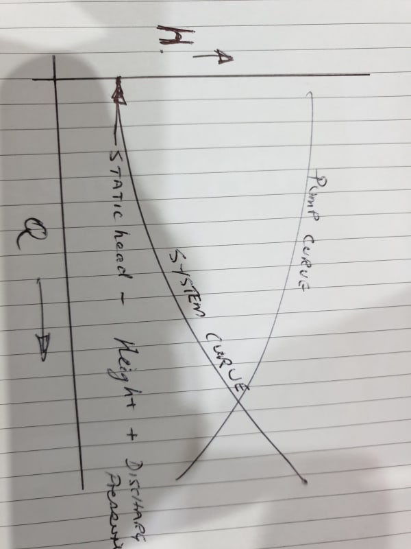

Hi everybody,
I am new to the forum and have a question that is stumping me. I was looking at a curve today
and I was wondering what the maximum GPM a 1" pipe can actually handle? According to the curve it is capable up to 100gpm, but when I look on engineeringtoolbox.com ( It is telling me that a 2" pipe can only handle 45gpm max. It didn't have a 1" option, but I believe 25gpm was what I saw when googling the capacity of a 1" pipe.
What am I missing?
Thank you for any help able to be provided.

You appear to be showing us a pump curve. This has nothing at all to do with pipe size. The pipe is part of the system to which the pump is supplying flow. Where the system curve intersects with the pump curve is the operating point of your system and pump together.
If your system is made of one inch pipe, the system curve will look like a parabola that starts at the origin (0,0) and goes off the top of your graph at roughly about 10 GPM.
The pump curve has nothing to do with the pipe size and flow. It is simply the source of flow.
How much flow depends on the resistance to flow in the pipe it is connected to.
That is dependant on how long it is, what the height or pressure is at the end and anything else causing friction losses such as control valves.
The table you link is quite clear that this is simply a start point and appears to be based on a similar pressure drop.
This graphical representation of the friction loss thru' a pipe system overlayed on a pump curve.
Trust this helps in understanding

The pipework, fittings, valves etc should all be considered in the system curve calculation, from inlet to the final discharge point.
