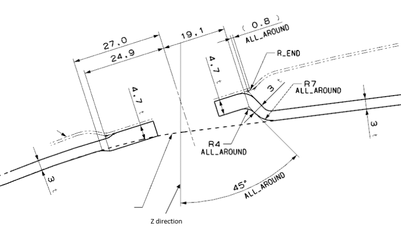

Hello, everyone! New to the forum, but have been reading many useful things here.
I have a problem doing blend that transition from concave to convex or vice versa.
I have attached the image and parasolid file.
I could make the blend if it is the same radius and less than 2mm. But that is not what I need. What I need can be seen from the image.
Also, any tips on doing blends such as this for future reference? I am new to NX and am having a hard time doing blends.
Any help is appreciated, thank you so much!
I am using NX11. Sorry, forgot to mention it before.

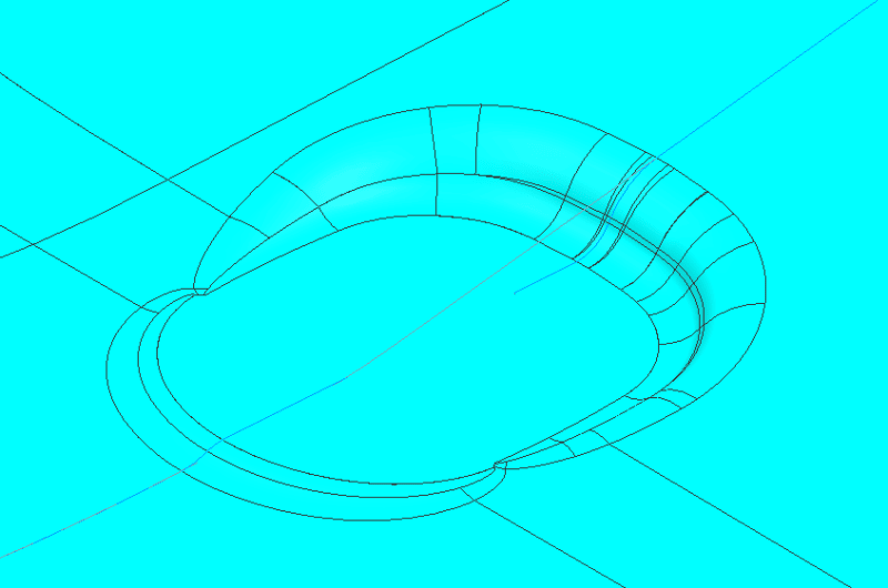

Theres something wrong with that back wall surface.
When I blend in this order according to picture from left to right.
7mm then 4mm
then the 7mm and 4mm from right to left. the 4mm only partially shows up.
When I export that to an NX11 compatible X_T it blows up
edit forgot picture

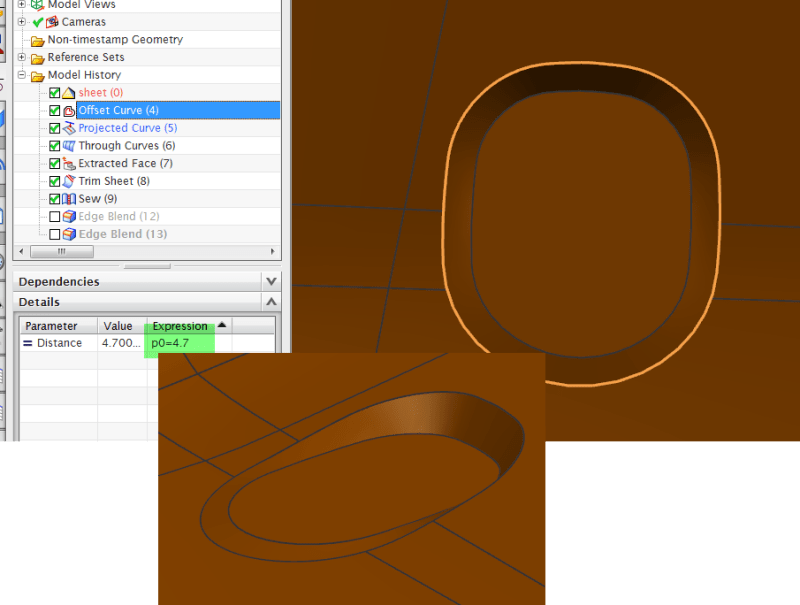

I did not succeed applying the blends as you require, but i played around with a slightly different shape, avoiding that tricky 4-edge vertex.
I created a offset curve from the planar face "inside", that "happened" to be 4.7 by quickly comparing to the upper outline.
then i projected that to the outer faces, normal direction from "inside face".
I created a Through curves sheet between edges of "inside face" and projected curve. ( alignment by points, output =sheet.)
trimmed and sewed etc.
this is how it looks without the blends. Blend r=7 and r=4 no problem.
What do you think ?
( I do not know the purpose of this model so i don't know if this modification is ok or not.)

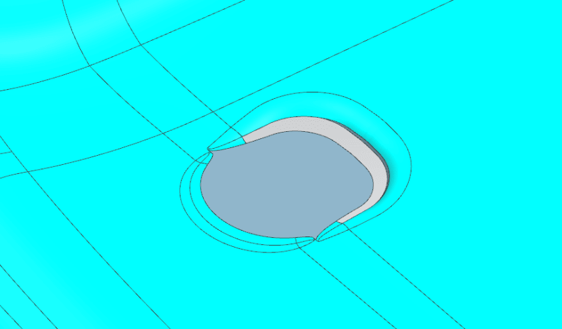

I also noticed that, I don't know why though. I made that back wall with law extension and then did an offset.
Checked it with examine geometry and didn't find anything wrong.
Made a new one with extrusion and draft instead of law extension and was able to made this:

However, I don't think it meet the needed requirement. It is a practice problem that I got and I need to make it according to:

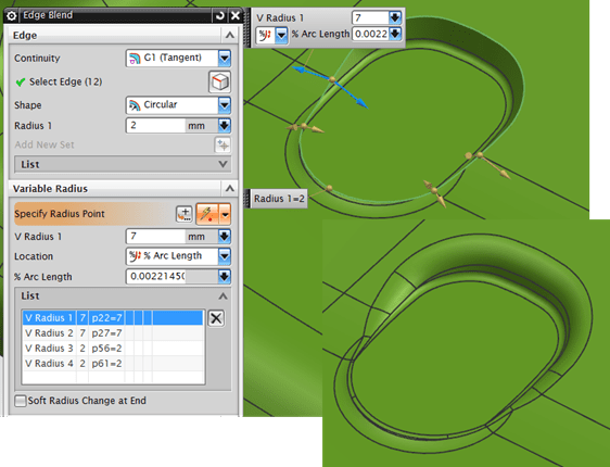

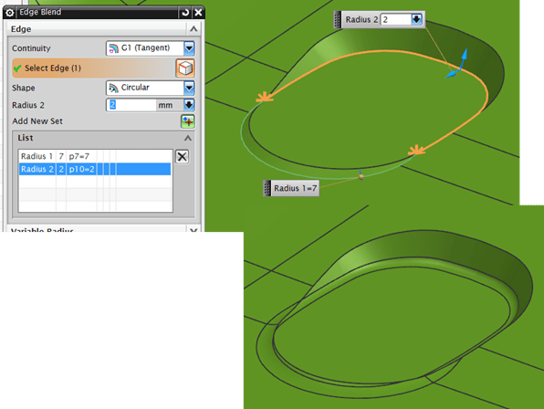

If i adjust the sizes slightly , instead of r= 7 and 4 ; I use 7 and 2. I can do the solution seen below.
Blend 1, two different radii ( this can be done as separate blends as well.) Note both are concave.
Blend 2, because of the previous blend, concave-concave, I get a tangent continuous edge all around.
this then requires a variable blend, 7-2-2-7mm ( Any order)
This is not according to the specs of radii 4 and 7 but the shape is since that "typical 2D-drawing view", doesn't state how the transition between the different radii should look.
