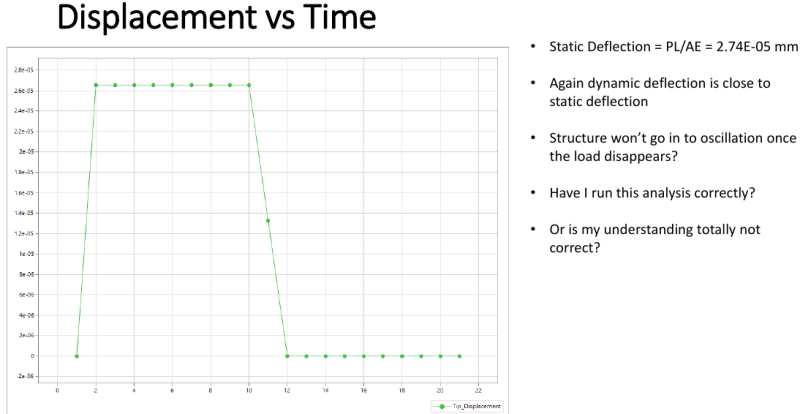

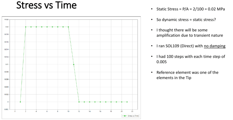

Thanks for the replies. I have asked my company to purchase Blevins. In the meanwhile, I did run a small test case and I got results which just confused me more. I have to admit that my understanding of Dynamic systems is evolving.
I hope the images are clear enough. Please help me out in getting a better understanding.

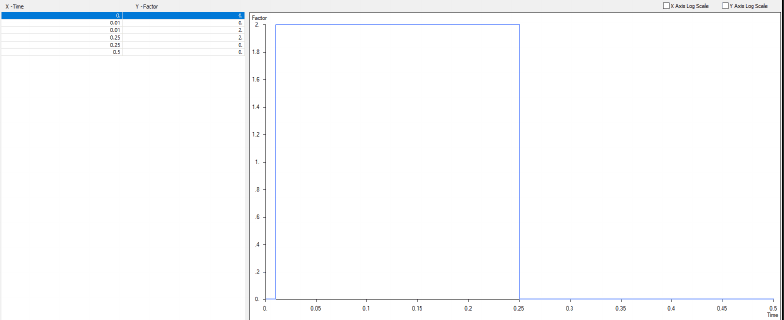

The loading is a step function with a factor of 2
Unfortunately I can't read the numbers on your graphs.
To see the dynamics of that system you'd need to be running a much smaller timestep, of the order of 1E-6 or smaller

All dynamics begin with Normal Modes. Run normal modes and find first frequency(lambda) of mode that represent rod movement in axial direction.
Now if you want to observe some transient behavior you should apply load at duration with same order as one period of oscillation (T=1/lambda) of rod axial mode. To capture transient behavior you should use timestep not greater than 1/12*T or 1/20*T. Think of it as you have one sine wave with period T and you need some number of points to capture it. So 6 points per half sine wave is bare minimum.
Otherwise your load period is greater than period of first axial mode so structure response to it like to static load.
That's one approach. The other is that the axial speed of vibration is 7000 m/s and the thing is 0.1m long.

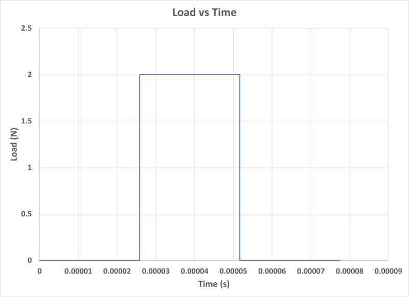

I created a loading function as follows:
Time(s) Load(N)
0 0
2.58398E-05 0
2.58398E-05 2
5.16796E-05 2
5.16796E-05 0
7.75194E-05 0
Here is a plot of Load vs Time:

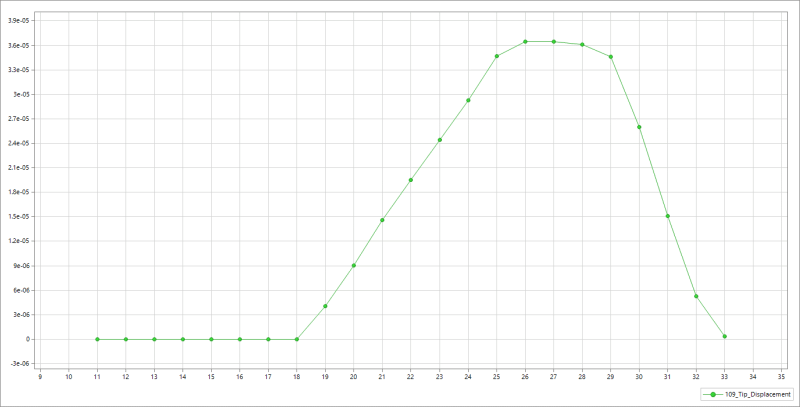

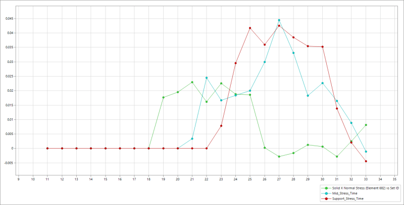

I ran SOL 109 with the above information and I got the output as follows:
Tip Displacement vs Time:
Axial Stress vs Time (at 3 different locations; near support, middle span element & tip element)

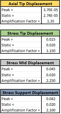

I calculated the magnification factors:
I can certainly see dynamic effects but I would like to hear if the above approach is fine or not!

I think your displayed time step is still too coarse to really understand what is going on. How much damping do you have? What is the x axis on the output graphs?
Cheers
Greg Locock
Hi GregLocock, there is no damping specified. The X axis on the output graphs represent case # (Case 0 will be at 0 sec & Case 33 will be at 7.75E-5 sec)
Your force pulse is 26 microseconds long, you've only shown 1 microsecond of the response. I suggest you plot several cycles of the lowest frequency mode, say 200 microseconds.

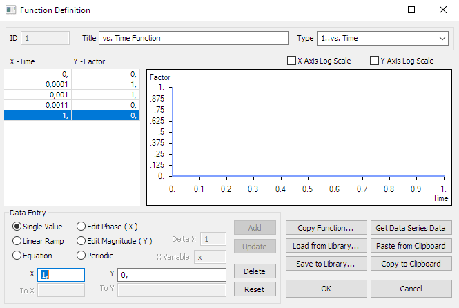

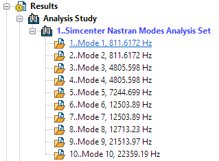

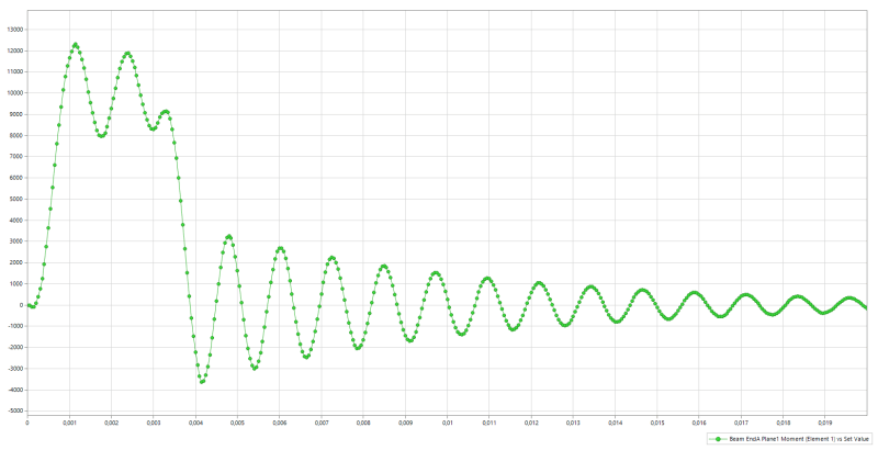

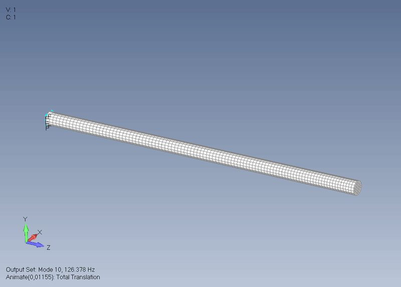

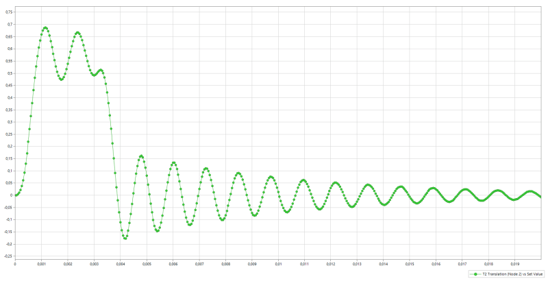

Here I made simple beam model with lateral load that excite first bending mode (811 Hz). You can clearly observe dynamic behavior both on nodes motion and bending moment.
I have included Nastran input files both for Normal Modes and Frequency Response, you can import them into Femap by File->Import->Analysis Model.
I have added 3% damping factor so you can see how oscillations amplitude decrease to zero but this should not affect initial peak values - it is not enough time for damping to dissipate any substantial quantity of energy.
Timestep ~ 1/25 of first mode period.

I have made error in my description. What i mean is you have oscillation period T=7.752E-05. You calculate timestep dt as (1/20)*T=T/20=7.752E-05/20=3.88E-06 sec.
Now you can estimate whole simulation time as Load Pulse duration + 10 oscillation periods (again rule of thumb, 10 periods should be enough to achieve periodic oscillations so you do not need to calculate further in time). What is load pulse duration? If it is unknown than I would start with 1-3 oscillation periods.
Load
Modes

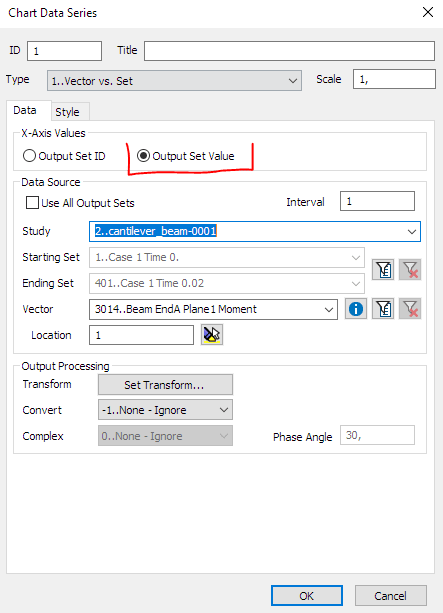

When you plot charts in Femap select "Use output set value" radiobutton so you plot value vs time.
