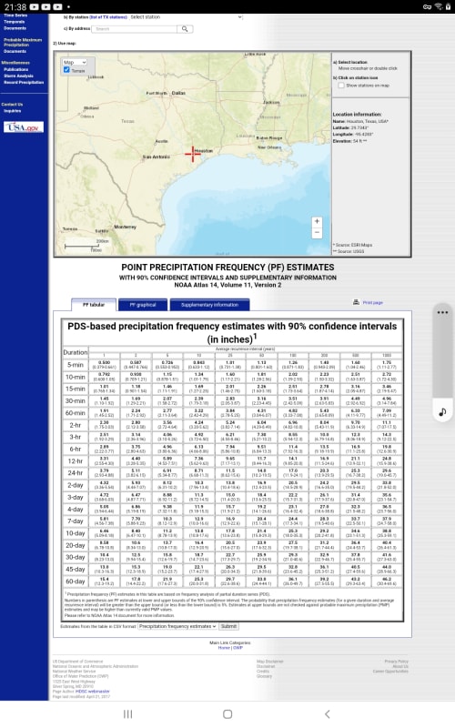

Thanks 1503, understood. This rain is meant to coincide with, and mildly exacerbate, a very rare and catastrophic event.
For that you need to look at the return frequencies. That's your indicator for the degree of severity of a catastrophic events.
Houston example latest NOAA data
Thanks so much 1503, very helpful.
