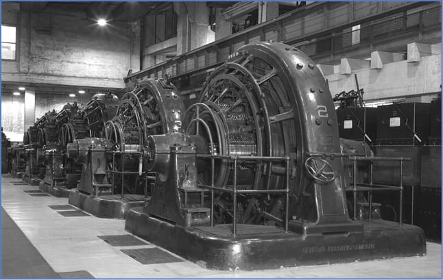

Dear Heritage Buffs, I am reading a report from 1912 in which the author is comparing rotary converters with motor-generator sets for the conversion of 440 V AC to 600 V DC for tramways use. Can you please explain the difference? In another report the DC power stations of that time are said to have an electrical machine described as a 'balancer'. Could you please help with this as I can find no description of this device?
An MG set or motor-generator set is either an induction motor or a synchronous motor driving a DC generator.

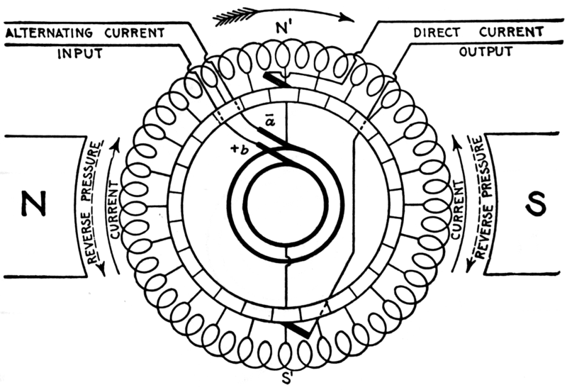

A Rotary Converter is a device that shares a rotor with both the AC circuit and the DC circuit.
The AC section may be wired for single phase, 90 degree two phase or three phase.
The single phase unit needs a starting circuit to work with a single phase input.
90 degree two phase has gone the way of the dodo.
The AC input may be three phase.
While these are most commonly used to produce DC from an AC supply, they are reversible and will produce AC if driven by a DC input.

Then someone realized that while the commutator extracted DC, each individual coil generated AC.
By tapping (connecting to) three equally spaced commutator segments, three phase AC could be extracted.
A rotating diode plate was fabricated and many brushed DC exciters were converted to brushless exciters.
The shops doing the conversions typically removed the commutators and brush gear.
What does this have to do with rotary converters?
It illustrates the use of the same rotor winding for either AC or DC.
This is the principle of a rotary converter.
Here is a single phase rotary convertor.
Here is a three phase rotary convertor.

If the device is a rotary converter, the windings on both ends of the machine are in common. One end will have sliprings, the other end will have either sliprings or a commutator.
If the two ends of the device are electrically independent, then the device is a motor generator.
There is a variation of the motor generator called a synchronous phase converter, which was a single-phase synchronous motor and a three-phase synchronous generator with common stator and rotor. The synchronous phase converter was used mostly in European electric locomotives to connect the 16 2/3 Hz single phase catinary power to whatever the traction motors needed.
The rotary converter winding diagram simplified. (the same one waross provided)

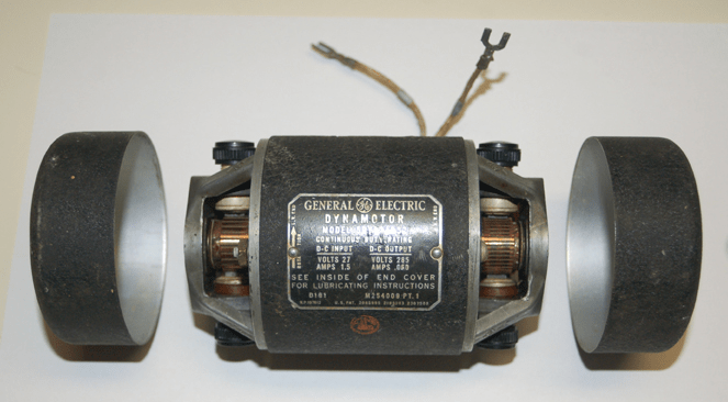

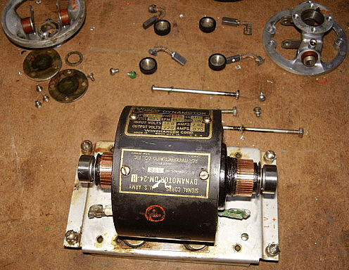

Has anyone mentioned the dynamotor?
This was a DC machine with two windings in the same slots and a commutator at each end.
One winding may be for 6 Volts or 12 volts and the second winding would be for several hundreds of Volts and be connected to a second commutator on the opposite end of the armature.
The low voltage winding was used to drive the device as a motor.
They were used to produce plate voltage for mobile radio transmitters.
