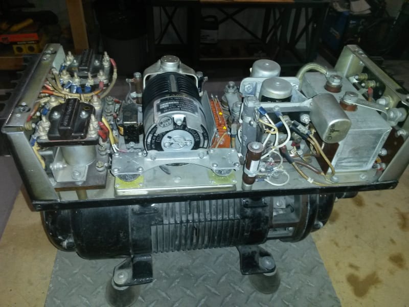

And it works the other way, too. A rotary inverter from a wartime aircraft that converts 28VDC into 120VAC Delta at 400 Hz sitting in a forgotten corner of my garage. I dunno what to do with it really.

And don't try running that inverter up without decent hearing protection (they scream like a banshee).

I have, you're right, it's loud.
I also got a cute little aircraft oil cooler fan motor to run off of it.
There wasn't much point of doing this, I admit.
Maybe the local aero museum will have some use for it.
