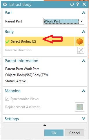

HI GUYS
I HAD TO UPDATE SOME FEATURES OF A MODEL AND UPLOAD IT IN OUR PLM SOFTWARE, BUT I REALISED THE MODELS CAME TO ME WITH A BROKEN LINK OR EXTENDED FEATURE, I AM TRYING TO REPAIR BUT NOT WORKING. CAN ANYONE PLEASE HELP ME WITH THIS REGARD, PLEASE REF THE PICTURE BELOW?
THANKS IN ADVANCE...
HI jerry1423 ITS NOT WORKING WHEN I MAKE THE LAST FEATURE AS "CURRENT FEATURE", I TRIED REPLACING THE LINKED BODY ASWELL, NO PROGRESS WITH IT. KIND OF STUCK HERE WITH THIS
It looks like if "feature (3) extracted body" is re-associated the rest of the model with update properly.
Edit feature (3) and select the body that is associated to feature (2)
If the body is highlighted before selecting it then deselect it and then re-select it, and press ok.
