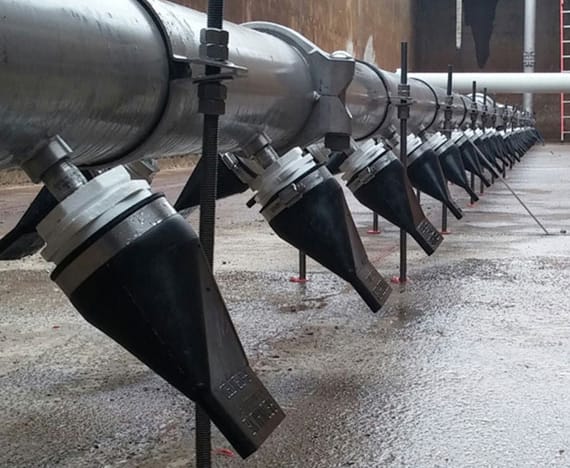

Replacing the nozzles on your aeration pipe with duckbills is an alternative to the vacuum breaker approach. Vacuum breakers and check valves do require regular maintenance if you do not plan on running to failure. In this case failure may damage your air pumps.
Tideflex®
Disclaimer I use these duckbill valves in storm water applications, not aeration systems. In storm water they have long service lives.
I would still run the charging line above the rim of the tank wall. Loss of air pressure with these duckbill valves installed would at most result in a slow leak.
