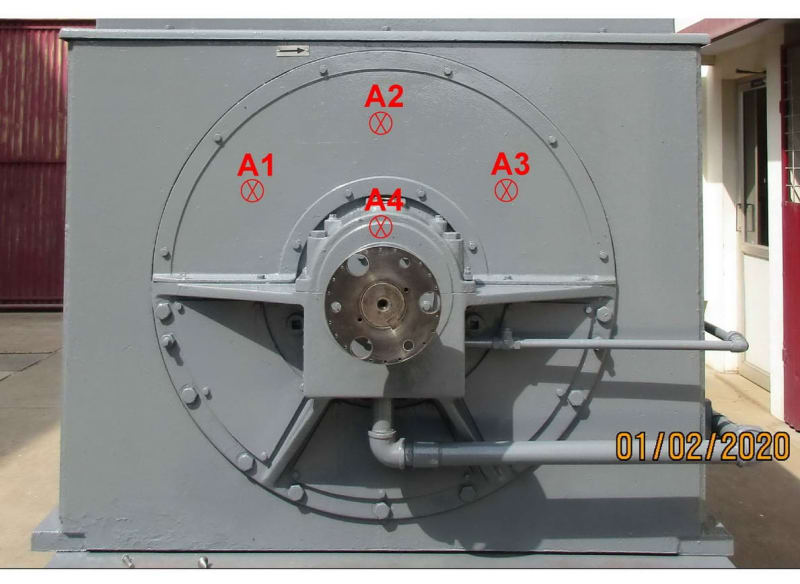

High 2X axial vibration in uncoupled 2 pole sleeve bearing motor 5
edison123
Oct 23, 2002
4,516
IN
On testing an uncoupled, 2 pole (3000 RPM, 50 Hz) motor on sleeve bearings, I found the following axial vibration frequencies (mm/sec RMS) on DE bearing top cover.
Overall - 3.91 mm/sec RMS
0.04 at 1500 RPM
0.89 at 3000 RPM
3.00 at 6000 RPM
0.05 at 9000 RPM
0.07 at 12000 RPM
I confirmed it is not electrical vibration since the overall DE axial vibration did not drop immediately upon cutting off the motor supply. The motor test bed is a machined bed in which I have tested many high speed motors successfully, so no bed issues.
The overall axial vibration in NDE bearing top cover was only 1.5 mm/sec RMS. (I see normally axial vibrations on both bearings are almost the same).
Vibrations in DE & NDE Horizontal and Vertical were also less than 1.5 mm/sec RMS.
Any reasons why this high 2X axial vibration only in DE bearing ?

is this a new motor? Refurbished ? Just being taken out of stores ? Were any repairs done to the shaft's DE bearing journal ?
I expect the the axial vibration measurement is being made on the DE bearing top cover close to the bearing, not out at the a larger diameter close to the windings.
What is the axial vibration on the equivalent location on the lower bearing cover ?
I'd do a simple "bump test" with a dead blow hammer etc, strikithe DE top cover axially close to the bearing, when the rotor has coasted down to 1000 rpm or so ( so the weight of the rotor is not yet directly connected to the end bell).
I think you will excite a 100 Hz/6000 cpm resonance of the DE bearing cover.
As to the mechanical condition exciting the resonance, I'd remove the top bearing cover and check the upper bearing insert for signs of rubbing. Then I would indicate the DE bearing journal at front. center, and rear. I expect you will find the journal has at least a few 0.001s inch TIR.
This runout may ("bent shaft") , or may not (half-fast shaft repair) extend to the DE shaft where a coupling etc will mount.

Yup, I have the same recommendation. It is pretty common for a large sleeve bearing motors to have a axial-direction resonance of the large thin plate at the ends of the motor above the bearings, similar to resonance of a drum.
Other ways of checking for that plate resonance:
[ul]
[li]map out the vibration, if the vibration is highest in middle of the plate and lower toward edges of plate, it matches resonance pattern.[/li]
[li]Also try pushing in the center of the plate and you may see a dramatic reduction in axial vibrations, it suggests resonance.[/li]
[/ul]
If you confirm plate resonance you may be able to solve it by stiffening the plate or arranging something to push in the middle of the plate. Or the gasket material and bolt torque may affect the resonance also (I have seen this type resonance appear and disappear after removing/reinstalling the cover).
The recommended TIR check is a good one too looking for potential sources of 2x on an uncoupled motor. I would say to also keep an open mind that it might possibly still be electrical twice line frequency exciting the vibration even though it persisted after deenergization (how long did the vib last after deenergization?). I think a lightly damped resonant system can take longer for vibration to die away after removal of exciting force than a non-resonant system.

Thanks guys. The motor was overhauled, rotor was rewound and the shaft journals and other shaft areas were grind polished with TIR of 0.1 0.01 mm max. Refurbished sleeve bearings supplied by the client were used. The DE bearing was opened up and no rubbing or skid marks were found in the white metal. Bearing seating on the bottom housing was also blue matched for over 90% seating.
I used two probes simultaneously on DE bearing top cover axial as shown below and both of them read the same values as above with 2x axial predominant. As can be seen, the top bearing cover is one solid unit with oil seals bolted at the front. The vibration was highest at the top (12 O' clock) and came down to 1.5 mm/sec at the bottom sump area. I too suspected resonance but did not have a solution to correct it given the top cover construction. The client was happy with 3 mm/sec vibration since it was running with 10 to 12 mm/sec before refurbishment, but I wasn't.
ETA: Soft foot was also checked and no change in axial (or any other) vibration was seen.
I'm not sure whether or not you're drawing any conclusion from that description / photo. But for me it doesn't rule out the vibrating flimsy end plate scenario at all. The resonant flimsy plate moves the solid bearing housing. That may not seem intuitive, but I have seen the proof... for example I have seen where you can go up and push your hand into the middle of the flimsy plate and watch the vibration go down on the vib meter monitoring the solid bearing housing below. Also the axial vibration higher at 12:00 than 6:00 fits this scenario.
I just posted the above to avoid misunderstandings (I wasn't sure why you highlighted the stiffness of the location of the vibration mount and never reported any vib readings on the plate itself). But I think you are probably looking at it the same way based on your other comment:

I don't know what you mean by a flimsy plate, this is a whole unit of cast iron housing. The high axial readings I posted are at this location.
Muthu
I was referring to the semi-circular plate above the bearing housing (not where you're monitoring). If yours is cast, my scenario might not be as likely but the checks I suggested are very easy (vibration check on the plate, examine effects of pushing on the plate or stiffening the plate).

Just to be clear, in the photo below, if you apply axial pressure at points A1, A2 & A3 in the top cover plate, you expect the axial vibration at A4 (at DE bearing top cover) to change if there is a top plate resonance?
Muthu
Yes, that's what I expect if there is a top plate resonance. Most likely the biggest effect when applying pressure at A2. I also expect vibration at least twice as high at A2 compared to A4.
