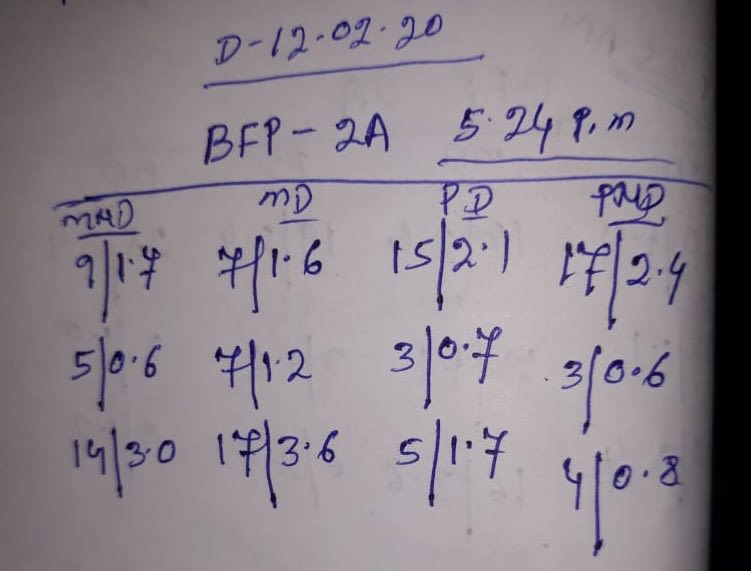

Feedback from the client
Decoupled motor vibrations (RMS Velocity in mm/sec) at Motor Opp Drive End (MND) and Motor Drive End (MD) in V/H/A.
Coupled motor vibrations (peak to peak displacement in microns / RMS velocity in mm/sec) at Motor Opp Drive End (MND), Motor Drive End (MD), Pump Drive End (PD) and Pump Opp Drive End (PND) in V/H/A.
The axial pressing of the top cover plate at locations A1 to A3 did not change the the axial vibration at location A4 of the motor DE bearing in both decoupled and coupled conditions. The top cover plate was not found vibrating severely.
The axial vibrations are stable from decoupled to coupled. Though the client is happy with the motor performance (when compared to high pre-refurbishment vibration levels of 9 to 11 mm/sec rms), I am still curious about the source of 2X axial DE bearing vibration.
